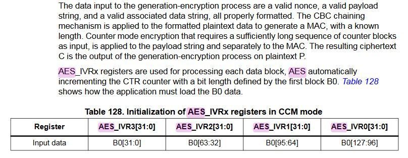

Thank you very much for your response. I finally found the source confusion.
In the documentation is commented that the IVR register needs to be initialized with the B0 vector comented in the NIST example, but this is not completely true.
In the example 2 from the standard the B0 vector is defined as:
56101112 13141516 17000000 00000010
(defined following A.2.1 Formatting of the Control Information and the Nonce)
While for the encryption phase in CTR mode the standard defines one vector (Ctr1) for the inicialization vector:
06101112 13141516 17000000 00000001
(defined following A.3 Formatting of the Counter Blocks)
Trying the encryption phase in python I was able to find out the correct configuration of the IV (Ctr1). Now the encryption phase of the CCM is working fine for me and I get the same results than the standard examples. This could be a recomendation to improve the documentation of the reference manual.
I guess now I have to change the IV to the B0 vector defined in the standard and perform the CBC phase to calculate the MAC. This is the next step to try for me.
