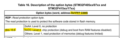

suggests that one cannot execute code from SRAM. Is that really correct?
Also there is ambiguity on whether the OTP area (512 bytes plus the control block) is readable in RDP2. Why say "512 bytes" and not just all-OTP?
The OTP area must remain usable under RDP2 and readable by internal code, but not accessible externally (with a debugger).
Above is from
2024-08-21 12:38 PM
No. In RDP2, there's no mechanism to interact with the chip anymore outside of user code. Debug interface is disabled, bootloader can't run.

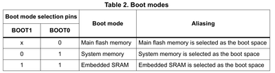

> What is "booting from RAM"?
Here are the boot options on the STM32F417:
Booting from SRAM is not a typical configuration.
> Do you mean that the vector table cannot be RAM-based?
No. Hopefully the above table clarifies that.
If you boot from flash, there are no restrictions on placing or executing anything in flash or SRAM.

Q1: Is there any doc on the initial value of the OTP? I would assume 16 x 32 x 0xFF but the RM does not say that AFAICT.
One could set it to say 0x00 and then lock it.
Q2: what is the easiest way for user code to tell if RDP2 is set? Some registers are not readable.
2024-08-21 2:52 PM
They're in flash. Erased flash on the STM32F4 is 0xFF. That's certainly in the RM somewhere. The following part of the reference manual lets you infer that 0xFF is the default value, but perhaps it could be more explicit.
Read the value, compare it to 0xCC.
