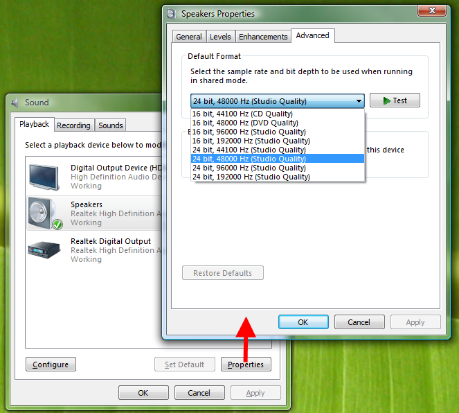

You need to change the sittings of you'rerecording device on windows: Audio sampling frequency and Audio channels.

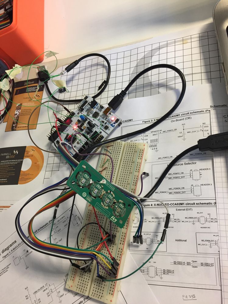

Hey, Zhangyi, have you managed to change the code? I'm facing the same issue. You probably have to change some code in the USB driver and solder/unsolder some resistors in the X-NUCLEO board. I'm okay with the soldering stuff, but the coding is driving me nuts hehe
