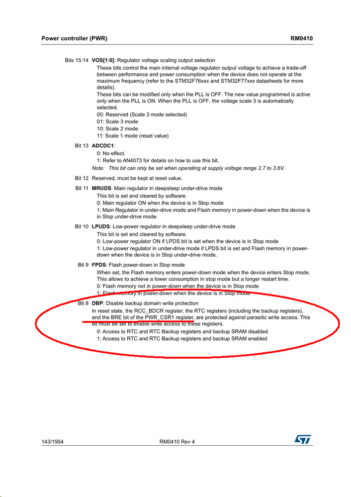

2020-09-04 4:53 AM
Oliver,
Nice catch!
> I can't see it in the manual but you need to set PWR->CR1 DBP before you can set BRE.
It is documented, sort-of, but not where you'd expect it:
@Imen DAHMEN ,
Can please all relevant ('F2, 'F4, 'F7) RMs be updated so that the description of the PWR_CSR(1).BRE bit contains a text, outlining that this bit is in the backup domain and thus DBP has to be set before being able to write into it?
Thanks,
Jan
