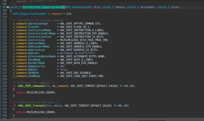

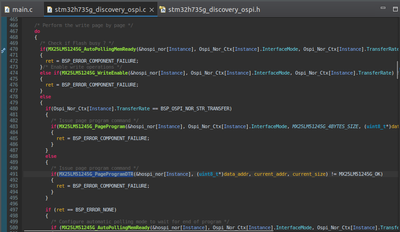

I am currently working on a bootloader project for the STM32H735, using the pre-configured ExtMem_Boot project provided by the STM32CubeIDE. However, I am encountering an issue when trying to write to the external flash memory at address 0x90000000.
I am using the function BSP_OSPI_NOR_Write to write data to the external flash memory. Here is the code snippet that performs the write operation:
When the code enters the function BSP_OSPI_NOR_Write, it fails at the following point within the HAL_OSPI_Transmit function:
/* Wait till transfer complete flag is set to go back in idle state */
status = OSPI_WaitFlagStateUntilTimeout(hospi, HAL_OSPI_FLAG_TC, SET, tickstart, Timeout);
This error occurs specifically during the execution of the MX25LM51245G_PageProgramDTR function call:
/* Issue page program command */ if (MX25LM51245G_PageProgramDTR(&hospi_nor[Instance], (uint8_t*)data_addr, current_addr, current_size) != MX25LM51245G_OK) { ret = BSP_ERROR_COMPONENT_FAILURE; }
Despite this error, the jumptoapp function seems to execute correctly. However, I am unable to determine the root cause of this issue.
I would greatly appreciate any insights or suggestions on what might be causing this issue. Has anyone encountered similar problems or have experience with writing to external flash memory on the STM32H735? Any tips or advice on how to resolve this would be extremely helpful.

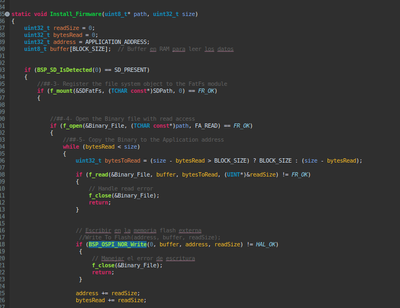

I want to provide a bit more context to help you understand my issue and offer some guidance.
Specifically, I'm trying to implement a function that reads a .bin file from the SD card and writes it to the address 0x90000000.

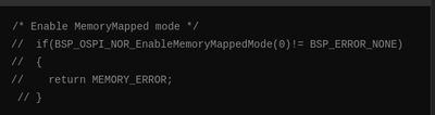

I am using the BSP_OSPI_NOR_Write function for this task. However, I encountered an issue when I comment out the MemoryMapped mode in OSPI_Startup:
When this section is commented, the code does not get stuck at MX25LM51245G_AutoPollingMemReady, but I always encounter a timeout error with MX25LM51245G_PageProgram.
Has anyone encountered a similar issue or have any suggestions on how to resolve this? Any advice on correctly writing the .bin file to 0x90000000 would be greatly appreciated.
Thank you!
2024-06-14 4:59 AM
Memory Mapped mode can't be used concurrently with command mode.
When not memory mapped, you can't access / see the memory content at 0x90000000
The OSPI Memory doesn't understand the mapping in the STM32, so it's address is zero based, so you'll want to mask the address passed in.
ie
.Address = address & 0x0FFFFFFF; // Mask to lower 28-bits

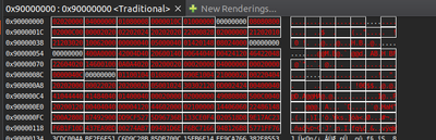

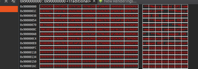

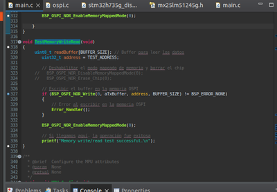

2024-06-14 6:06 AM
Thank you, I can run my code.
But Im trying to:
with
uint8_t aTxBuffer[] = " ****Memory-mapped OSPI communication**** ****Memory-mapped OSPI communication**** ****Memory-mapped OSPI communication**** ****Memory-mapped OSPI communication**** ****Memory-mapped OSPI communication**** ****Memory-mapped OSPI communication**** ";
but:
is something wrong?
I changed this as you say:
many many thanks @Tesla DeLorean
2024-06-14 6:16 AM - edited 2024-06-20 4:23 AM
