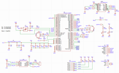

The microcontroller part of my board is in the image below, in case it's a hardware problem, but I don't think it is anymore.

Here are few hints , you need to manage dynamically the Pull-up of 1.5K on D+ PA12 - R31, Once USB is requested and USB cable present to active it using a GPIO . Having it static as shown in Self powered application may not work. Hope It helps you.
Cheers,
STOne-32.

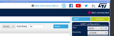

So use CubeProgrammer, mode (blue box-> set to USB UART) , then try connect with your cpu in boot mode.

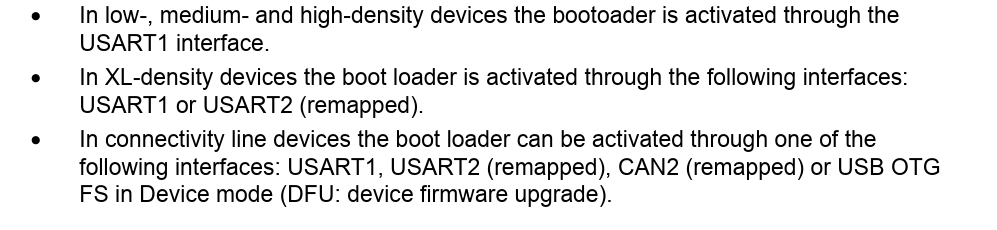

2024-03-15 8:38 AM
Sorry, @STOne-32 ,
I forgot... :) only connectivity line has:

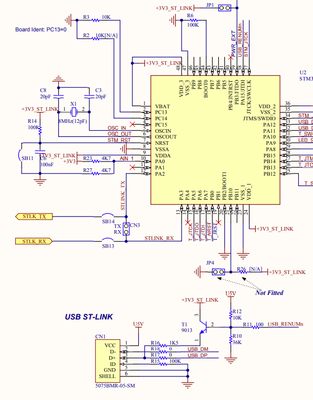

I have researched after reading your post, and found an example using the same uC. Here it is used a transistor to switch the pull up from the PA15/JTDI pin. I did this with my board, but since I don't have a transistor in hand right now (and would not like to solder in all of my boards), I soldered a wire from PA15 to the resistor instead of the constant Vcc I had before. I don't think it would be a problem because with 3v3 and 1k5 ohms, the current would be 2mA, so it should be ok? I appreciate any feedback.
Unfortunately now windows don't recognize the usb at all. Is there any code I need to load in the uC? Is PA15 really the right pin? Is there anything else wrong?
