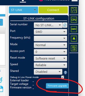

2025-07-29 12:19 AM
@FBL wrote:2. Upgrade or reflash the STLINK firmware using STM32CubeProgrammer, as firmware corruption can sometimes cause enumeration issues.
Is there any manual for that? Which interface shall be used, where do I get the firmware from?
2025-07-29 6:32 AM
The only way to update firmware is using ST tools. If the programmer can't connect at all, no chance of that happening.
2025-07-29 7:01 AM
OK. I thought I would be able to flash with another ST Link directly over JTAG/ SWD interface. I was wondering, if this is available on one of the connectors.
As USB is not recognized at all I cannot use the standard way of flashing the firmware.
