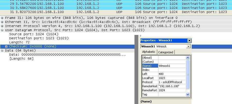

hello forum,
I am trying to send an empty UDP packet to visual basic 6.0 winsock
as you can see in attached picture wireshark ''sees'' theUDP packets
howeverwinsock never go into below subroutine ( it doesnot getthe packets)
what is the missing thinghere?
thank you

2012-12-28 7:44 AM
Not familiar with how it works in VB, but building an app using WinSock you need to register the application with the Windows Firewall for it to work as expected.
2012-12-28 10:31 AM
The easiest way to debug your VB program is to create a second socket in VB and send data to yourself. You can either use your own IP or the loopback address 127.0.0.1; whether it will actually make it out on the wire or not depends on the stack in Windows (though I wouldn't count on it). Either way you can test your construction of listening on port 1023 and the data receive function without even leaving your PC.
Dan2013-04-22 5:00 AM
hello forum ,
I succeeded to send ''TEST'' to PC from my STM32F4 however only with a cross cable ( directly from STM to PC ) why cant I send when I conect STM to adsl router ? has anybody a working UDP code for STM32F4 thank you2013-04-22 6:23 AM
''why cant I send when I conect STM to adsl router?''
Probably because your rouer configuration does not allow it?
This might be useful:http://www.simplecomtools.com/productcart/pc/viewPrd.asp?idproduct=6&idcategory=5
You should start by seeing if you can successfully send & receive UDP packets between 1 PCs on your network...2013-04-22 7:43 AM
