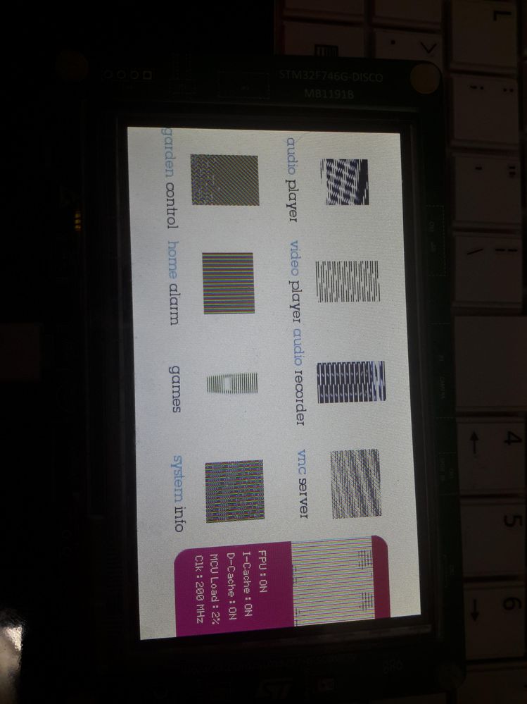

Tanks alot. I change the .ICF file. It works.
But when I download the project into Mcu, there is two warrning and one erro durring intialization of debugging session.
What is the problem?
Posted on November 22, 2017 at 22:41
You would need download software that is aware of the QuadSPI implementation on the board (pins, chip, etc). The ST-LINK Utilities have an 'External Loader' that provides support for loading the external memories.
Posted on November 22, 2017 at 23:07
I dont understand, what have i do?
You said that the external memory isnet programed?
