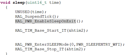

I found a issue.
if the code is
HAL_PWR_DisableSleepOnExit();
HAL_TIM_Base_Start_IT(&htim2);
it will stop at "if (IS_TIM_SLAVE_INSTANCE(htim->Instance))", but i didnt set break point at here.
if i change code:
it will run success
Does anyone know anything about this?

Welcome in our Community and thank you for the contribution. Is that possible to know the compiler used and also the Optimization level that generates this issue . If you can share the generated assembly to understand how the CPU sleep is entered ? It seems a scheduling timing issue and best to ensure that that disabling SleepOnExit is already propagated to the core register .

Thanks for your reply. Sorry, I misrepresented it. It's not HAL_PWR_DisableSleepOnExit(). It's HAL_PWR_EnableSleepOnExit.
It will stop at "if (IS_TIM_SLAVE_INSTANCE(htim->Instance))".
I also check the assembly language and register .It seems not this issue.
The optimization level is -O0. It seems not this issue too.
I put whole code at here https://drive.google.com/file/d/1C0Okxb4L-GLFftIXyY93LVBHNR7QFbBk/view?usp=sharing
