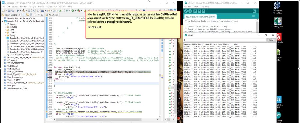

·        when STM32 send data, more than bye per Start/Stop procedure, Arduino received and showed the right informacion (TX and RX are the same).

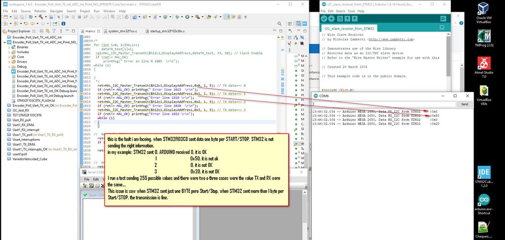

·        when STM32 send justa one byte per Start/Stop procedure, the information received on Arduino side, it is not the same send from STM32
·        As HT16K33 needs to receive configuration commands byte per byte and Data to be displays can be send one or more bytes per start/stop procedure, so as STM32 looks like is not sending one byte correctly, the display is not working (this is my assumption)

STM32f103C8 send data using i2C, if more
than Byte is send using HAL_I2C_Master_Transmit, Data is sent and received
correctly in remote Device (my tester is Arduino), please see picture N°1.
if HAL_I2C_Master_Transmit send one
byte, Arduino ( and HT16K33 too) are not getting the right data sent, please
see picture N°2

One more comment:
if HAL_I2C_Master_Transmit_IT is used (instead HAL_I2C_Master_Transmit), same behavior......if HAL_I2C_Master_Transmit_IT send one byte, it failed, if HAL_I2C_Master_Transmit_IT send several bytes, it works ok.
