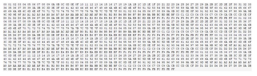

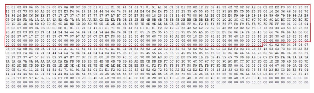

2018-11-11 9:35 PM
As you said, the hex bytes were converted to be ASCII before they were dumped to Uart. But the result is same. After thinking about it, I guess that the fast streaming of SD card may cause the lost of SDIO fifo buffer. Then I tried some ways to test, including enlarging the SDIO clock divider, and turning off 4 bit wide bus. At last, when cancelling HAL_SD_ConfigWideBusOperation, SDIO can read the correct bytes from SD card. So do you think it is a fault of the software or hard ware of wide bus?
Two images are attached, the image with wrong bytes is what Terminal received by ASCII format, while the other is the right one after turning off wide bus.
