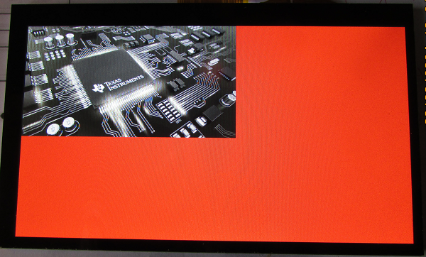

all is working fine but when I switch to RGB888 I get only white and black

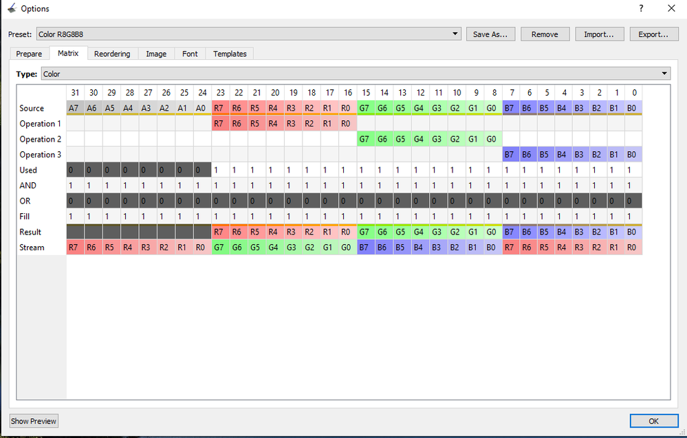

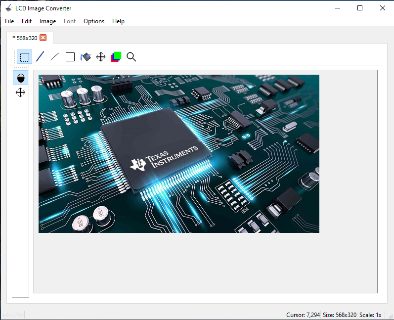

I use the image converter LCD-Image-Converter-20161012 tool explained in the article
the preview show color picture like all is setup right but still I get black and white

this is new image generated in RGB888 format, the image contains new RGB888 generated format. All pins R0-R7, G0-G7,B0-B7 connected, all 24 pins plus signal pins.
When you generate code for RGB888 in CubeMX, it assigns 24 pins plus signal pins. All is connected.
Old RGB565 image wouldn't display, it would be distorted. So it wouldn't look like on the first picture. If you were familiar with RGB display this is something you would know.

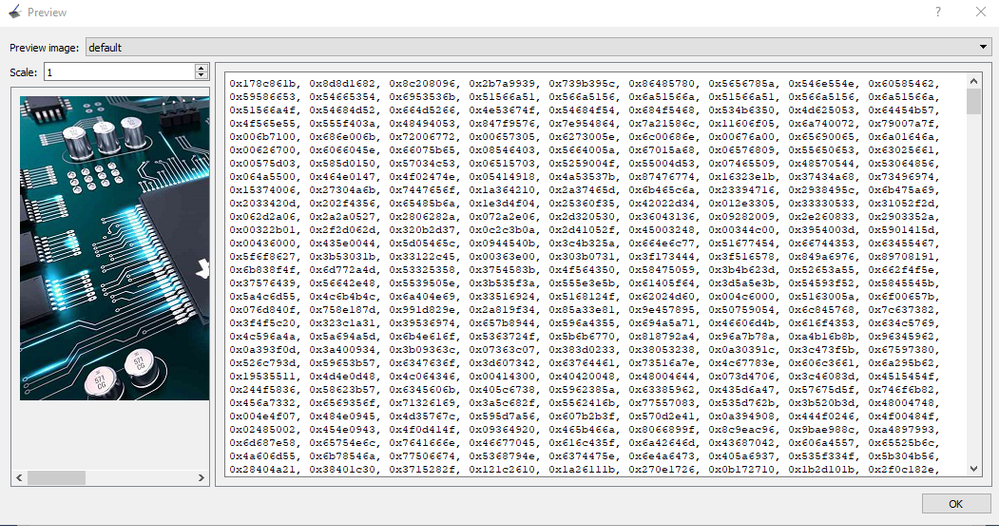

Try show part of image src file generated ...

see the last picture, it shows part of the image file generated. but I doubt that after looking at it you can provide solution.
const uint32_t image_568x320[136320] = {
0x178c861b, 0x8d8d1682, 0x8c208096, 0x2b7a9939,
