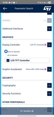

2025-12-12 6:57 AM
You can use the Parametric search to select how many FMC, LTDC or any other peripheral you are looking for:
Best Regards.

2025-12-12 7:04 AM
Indeed, but there is only check box there:
So you can't search for multiple peripherals like I2C, SPI etc. That's why I was asking.

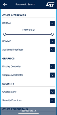

2025-12-12 7:12 AM
The Check box means there is only 1 instance per MCU for this interface. If more interfaces available, you will find a scroll bar to select the number of instance:
Best Regards.
