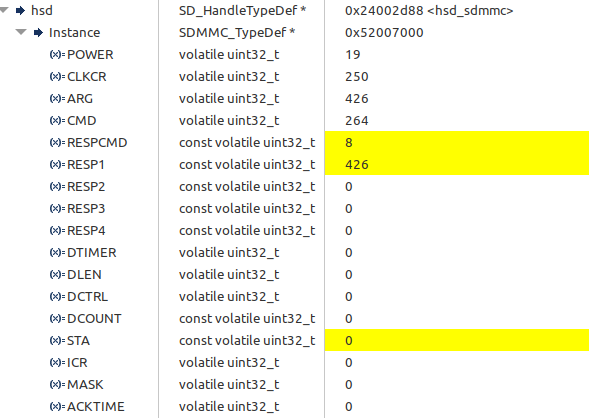

When the command passes on the failing card the hsd>instance structure looks like this:

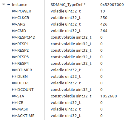

When it fails it looks like this:

I am not certain, but I suspect the problem has something to do with a register not being handled correctly either on the driver side or on the card side. I think that because it looks like, from what I provided for the instance structure, that the CMD8 is not responding as the RESPCMD and RESP1 registers are 0 for the card that does not work.
