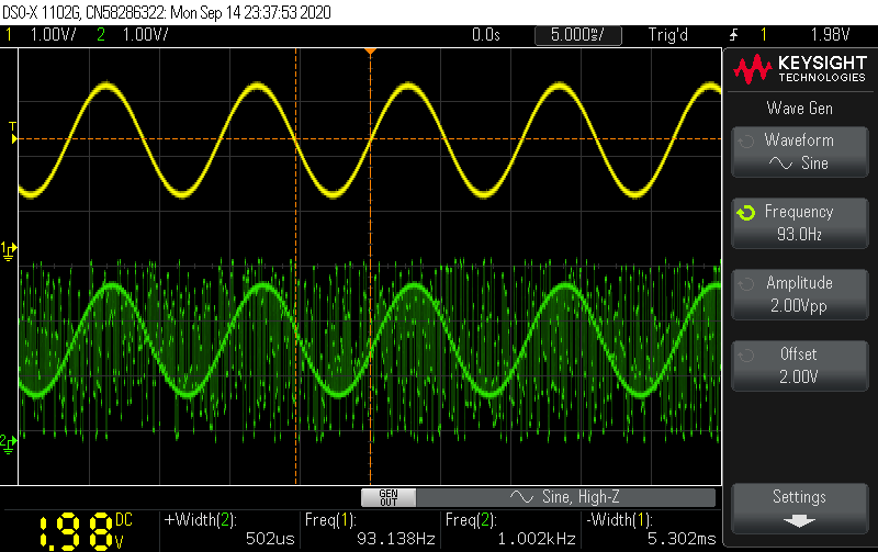

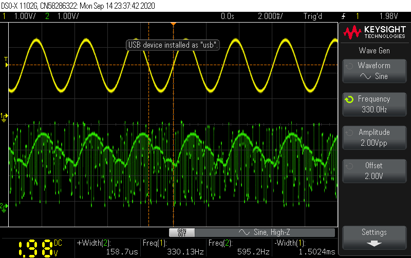

Hey guys!
I am trying to implement a difference equation into the STM32 MCU, however Iam getting this from the output of my DAC and I have no idea why this is happening?
