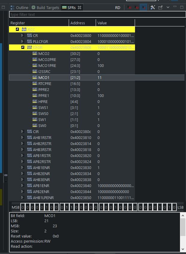

}Upon debugging line by line, line 25 is where the problem happens. Its setting the prescaler and clock source for MCO1 as (binary) 100 and 11 which is /2 and PLL respectively as shown in the screenshot for SFRs, this is correct according to the reference manual and should give 42MHz.

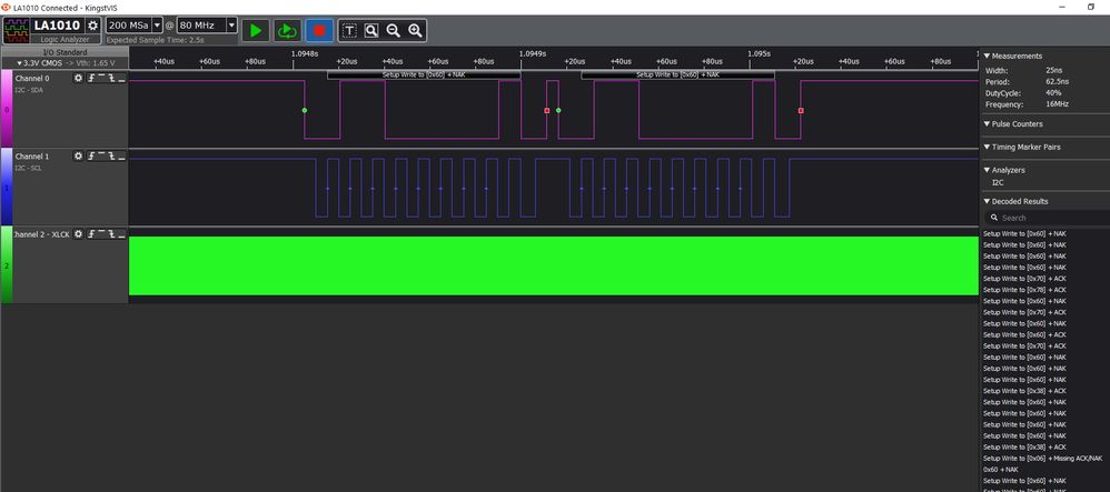

Below is what the correct I2C looks like when line 25 is removed. (The green squarewave is the default HSI output on MCO, 16MHz):

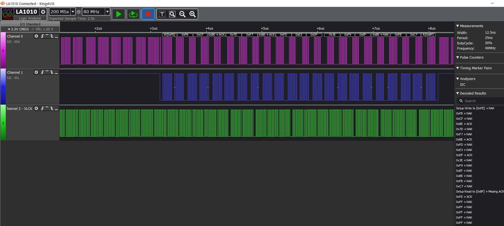

Below is what happens when line 25 is left in to make MCO1 42MHz as wanted but other pins are affected and MCO1 (green square wave) isn't even 42MHz.
