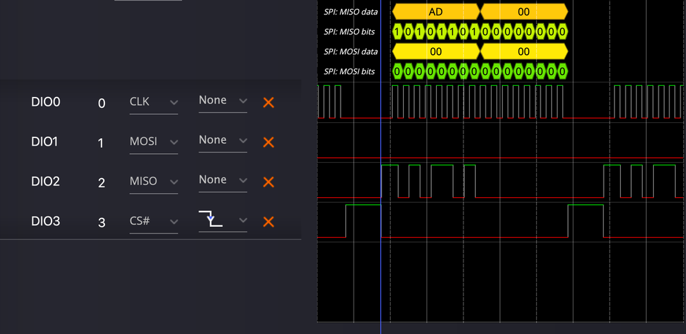

I am transmitting the 0x00 0x00 read command on MOSI and hoping to receive 2 bytes on MISO that describe the position of the encoder. However when I probe the lines with the logic analyzer function of my oscilloscope, I see that as I turn the encoder, only one byte is changing; the other one isn't changing. See image below. Also, I have the SPI data size set to 16 bits. I have a feeling that the issue has something to do with the BUFFERSIZE parameter. Any help is much appreciated.

Look at the timing diagram in the datasheet. It requires 2.5 µs delay between the two bytes.
Send one byte, wait 2.5 µs after the first byte is received, and send the second one, without raising CS# between them.
Mind the rest of the timing parameters too.

Ah, that... sorry I did not read the original post carefully and was under the impression that the STM32 is the SPI slave... sorry for the confusion.
This is not trivial to pull out just by clicking in CubeMX and writing some HAL statements. The delay may presumably be longer, there's no max given. The usual way to handle this would be to combine timer (possibly interrupts) with SPI, an unorthodox and possibly bumpy road would be to pull this out entirely in SPI interrupt, by switching SPI clock pin to GPIO output for one byte transmitted in between the two "meaningful" bytes.
It may be easier to do this by avoiding SPI entirely, bitbanging it in a timer interrupt.
