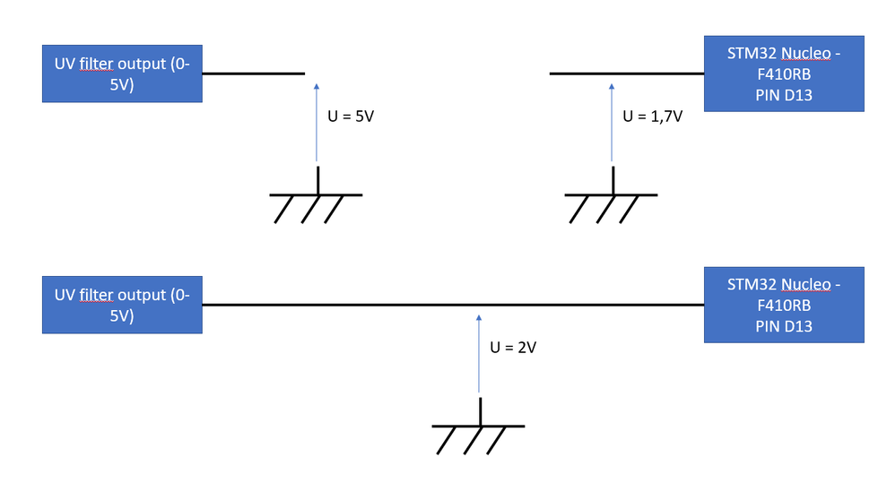

I have a UV filter that sends back a 0V-5V digital signal that I'm trying to read on PIN D13 (PA5).
The issue if the following (I'm using a multimeter to read the voltage, and all components have a common ground):
Even though I can interpret the signal, the imposed voltage on the UV filter makes him go into default mode.

2023-04-29 2:28 AM
PA5 (Arduino D13) pin is connected to an LED ("user LED") - check the Nucleo schematic.
2023-04-29 5:09 PM
And remember that analog inputs on some STM32 are 3.3V tolerant only, so don't connect a 5V signal to it, unless you made sure reading the datasheet that this is safe to do so.
