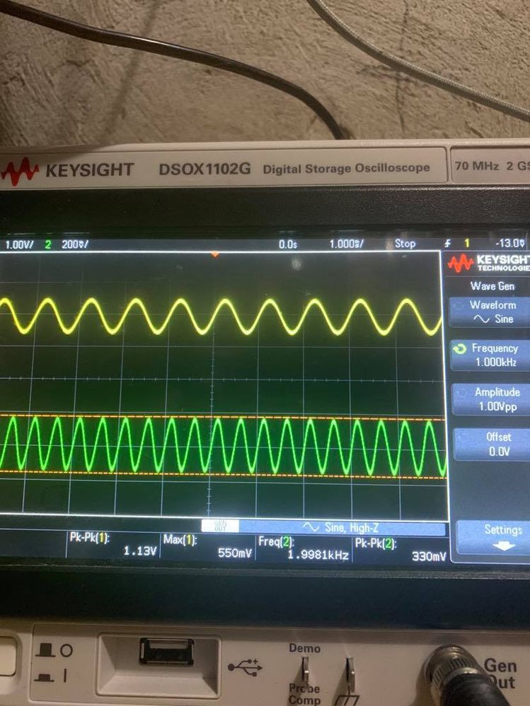

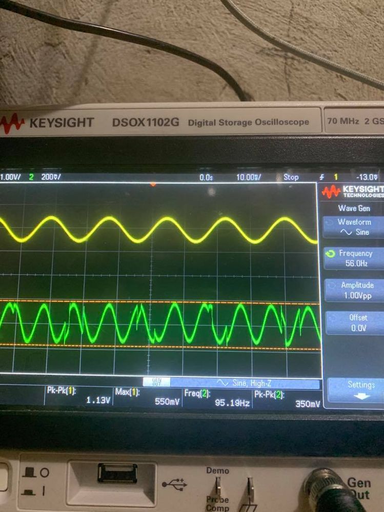

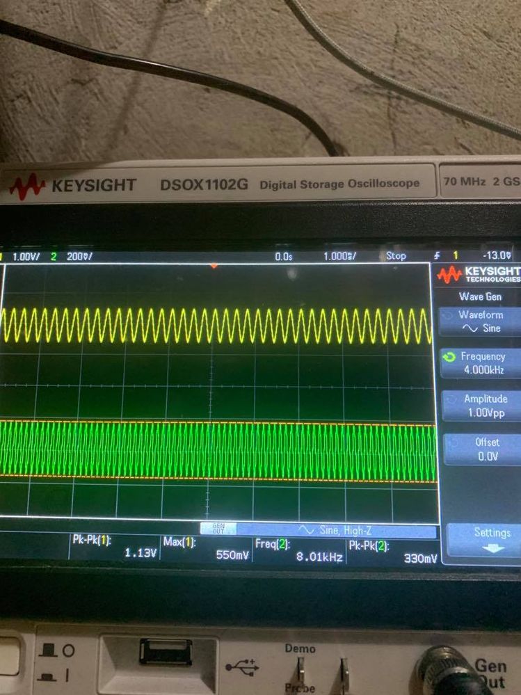

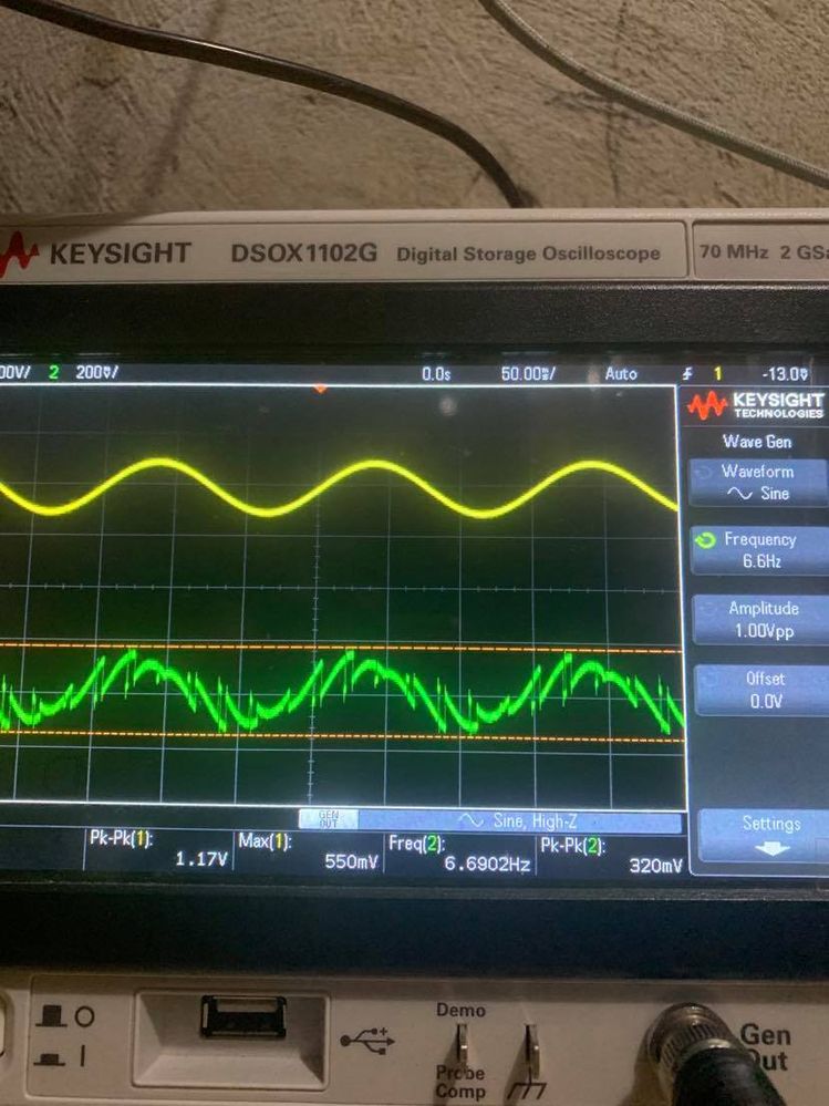

Essentially what I am trying to achieve is sum both the left & right channel to produce a mono signal to be outputted via I2S as the subwoofer line.
The problem I am having right now is that after summing the samples and sending it back to the peripheral I am observing at least double the frequency compare to the input and I have no idea why. Also at lower frequencies the signal looks chopped (see pictures)

}Results: @ 6Hz
@ 56Hz
@ 1kHz
@ 4khz
