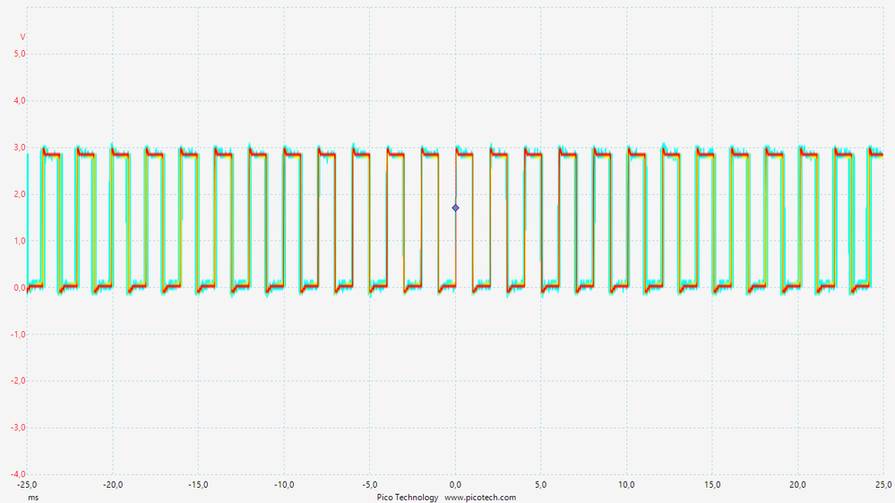

I attach a scope snapshot of the 512 Hz signal with "persistence" enabled. Triggered on the blue diamond in the center. As you can see, the farther out you go, the more the edges (both rising and falling) show these as yet unexplained deviations.
Could the output signal be affected by any other activity/peripheral/interrupt? If that were the case, how come this doesn't equally affect the 1 Hz signal?

Any coupling of RTC OUT to the Oscillator pins?

But a coupling issue is beginning to look likely, I guess.
Not entirely sure how to prove/disprove this hypothesis :(
