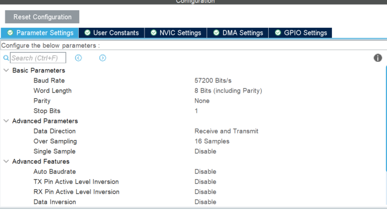

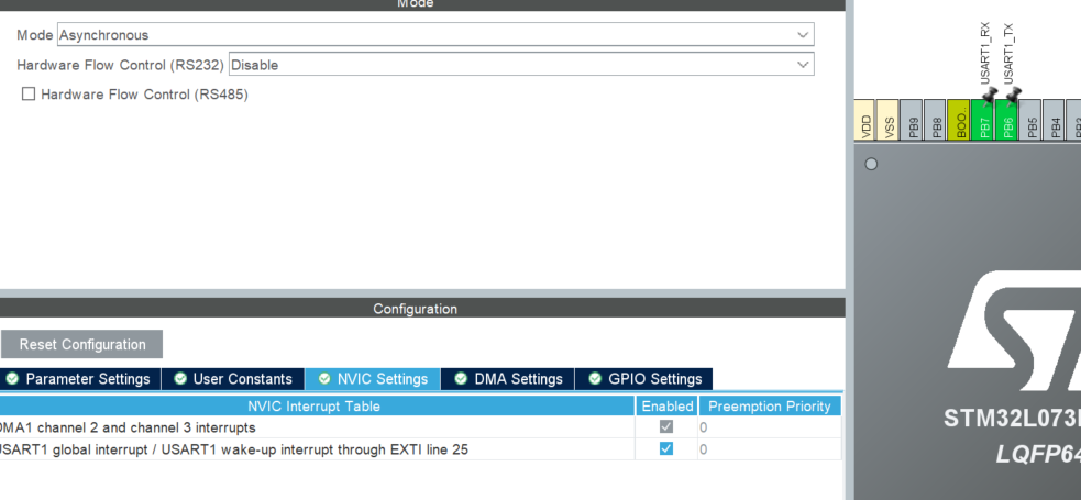

I am using a STM32L073RZT6 MCU and the Cube IDE V1.11. Using the .IOC, I instantiated UART1 on PB7-6 with global interrupts enabled and a DMA service for RX. On the PC side of things I'm using PuTTy as a sniffer and a UART to USB cable for COMS. I have provided screenshots of the configuration, PuTTy output and code snippets below. Each time I transmit a character to the MCU, the rx callback runs twice, but, on the second go around, the rx buffer seems to be reset and transmits 'None'. While I am confused by this added behavior, I mostly am concerned with why it runs the call back twice. Any guidance would be appreciated. Thank you.
