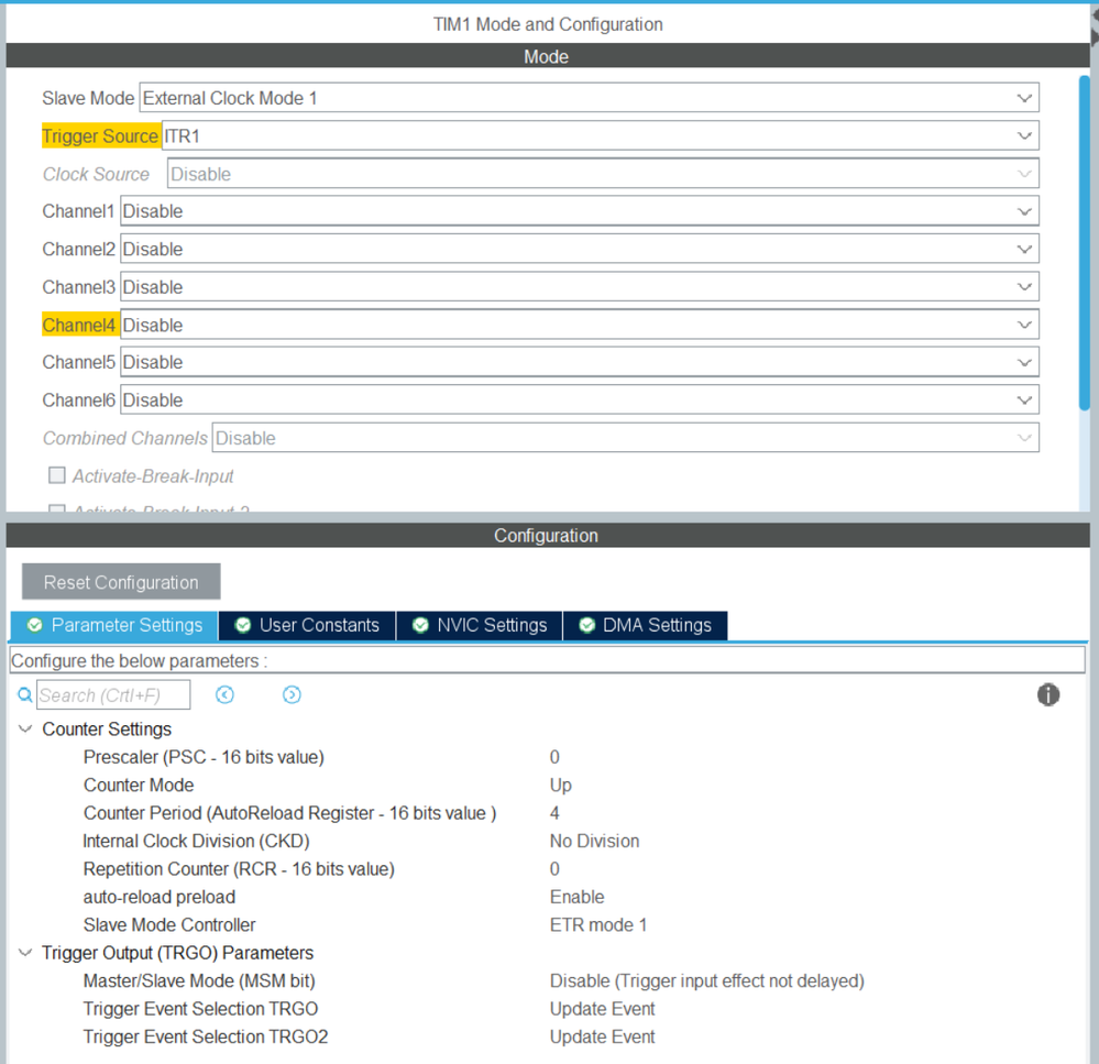

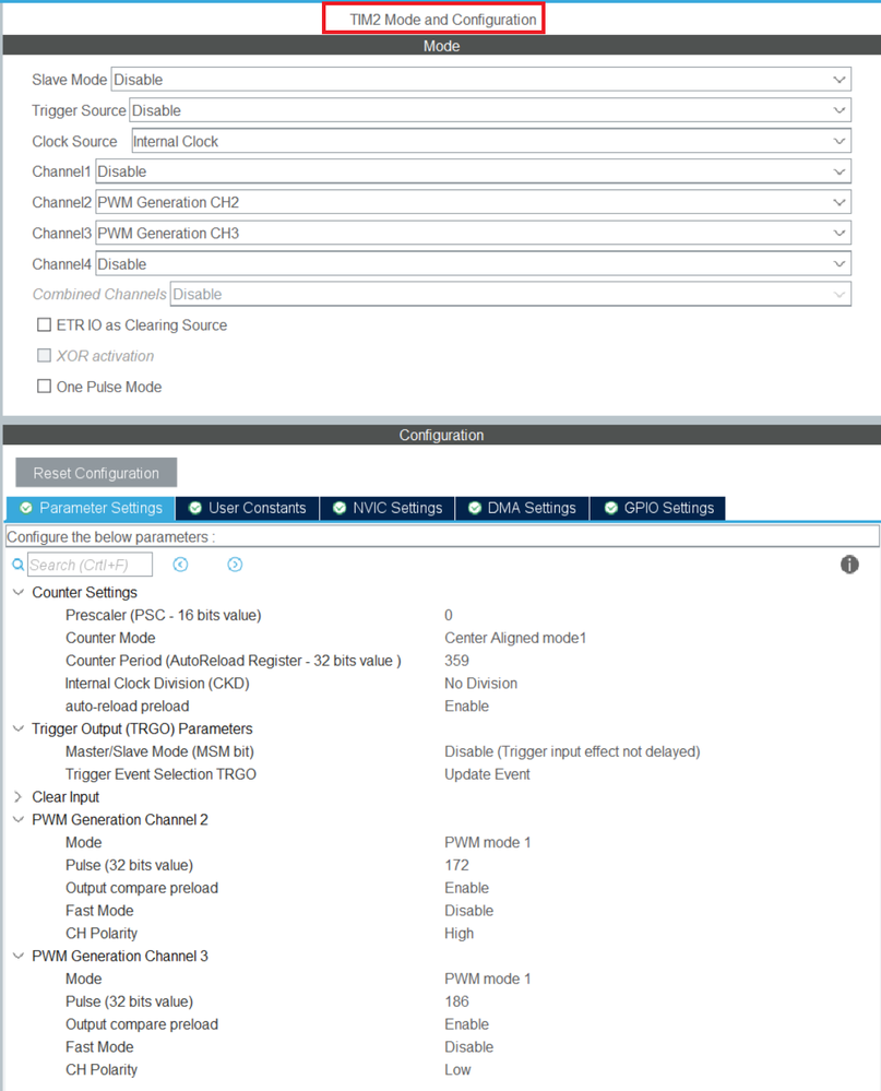

I use TIM2 for PWM to switch the MOSFETs and TIM1 to count output events of TIM2 (TIM2's arr = 4, meaning that every 5TIM2 overflows, TIM1 overflows as well). Using the debugger, I checked that TIM1 counts appropriately.
I set ADC conversion to be triggered by "Timer 1 Trigger Out Event," and it seems like the AD conversion is not triggered. (+using DMA in circular mode).

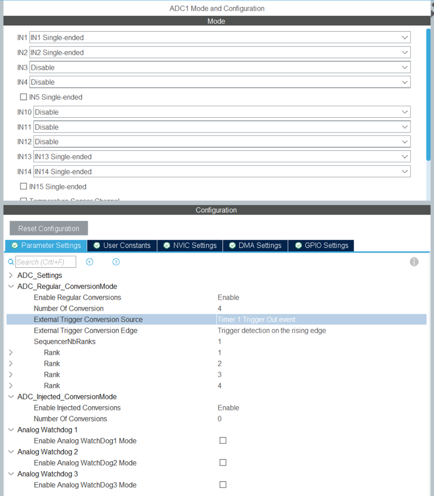

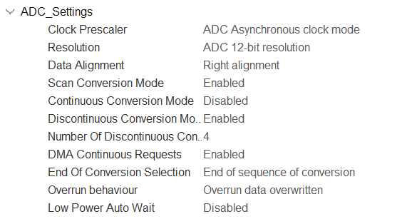

Hi Amel, thanks, but this didn't solve the issue. I, however, managed to find a solution- my ADC setup in CubeMX was wrong. It should be as follows:
