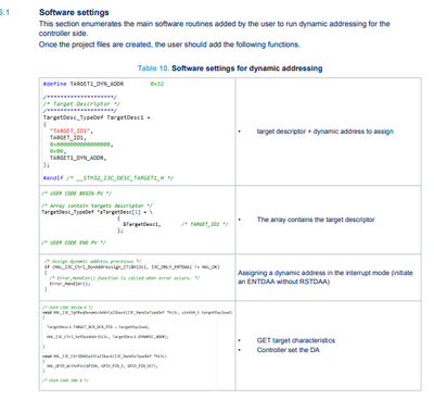

For more details about the I3C communication using STM32 MCUs, please check this application note: Introduction to I3C for STM32H5 series MCU - Application note .
Foued
2023-07-27 10:28 AM
Dear Foued
I was referring to this page before, but I was still confused about how to write it, so I came up to ask
And because I connected the X-NUCLEO-IKS01A3, I need a sample program, so I used the sample code in the IDE, the name is I3C_Sensor_Direct_Command_DMA, this can make me move, but I need to remove a piece of code.
