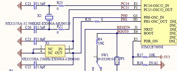

2020-11-29 6:11 AM
Hey can you tell me which 25Mhz crystal are you using i have been developing stm32f767 board and i require that crystal part number thank you
2020-11-29 7:02 AM
The STM32F7x9I-EVAL uses this NX3225HA 25MHz EXS00A-CH00343 (probably 12pF)

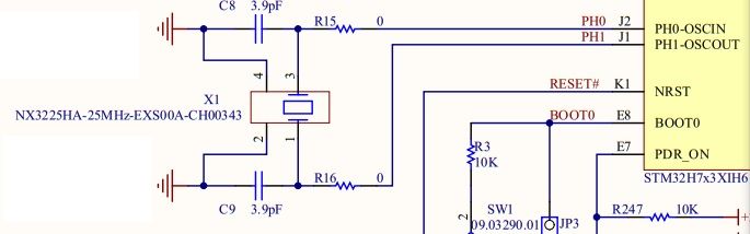

2020-11-29 7:22 AM
STM32H743I-EVAL
