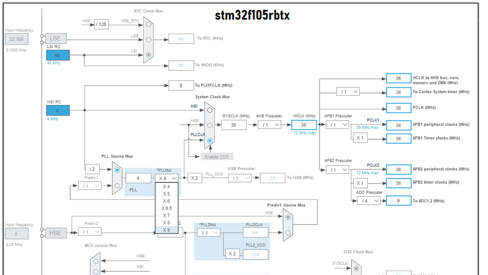

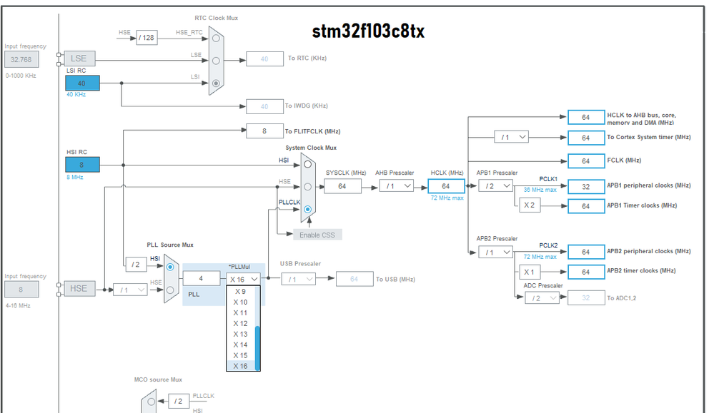

Why does the stm32f103c8tx have completely different options for its PLL multipliers than stm32f105RB??
Javier1
Principal
currently using stm32f105 (HSI+PLL) ,and i am trying to clock faster than 36Mhz
They are from the same stm32 familly, why is the PLL of the stm32f105 limited0693W00000Np2HhQAJ.png0693W00000Np2GvQAJ.png
I am using CubeMX 6.4.0

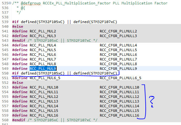

Javier1
Principal
Looking into stm32f1xx_hal_rcc_ex.h

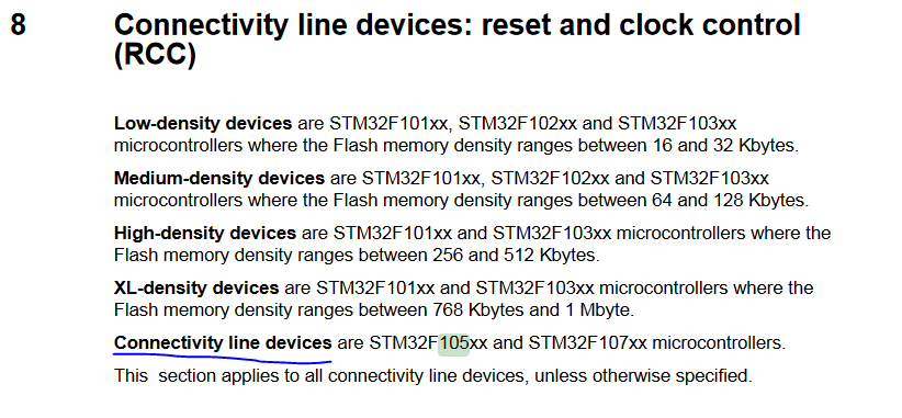

Javier1
Principal
From the RM0008 reference manual (page 126) :
It looks like stm32105 is a "connectivity line device"
