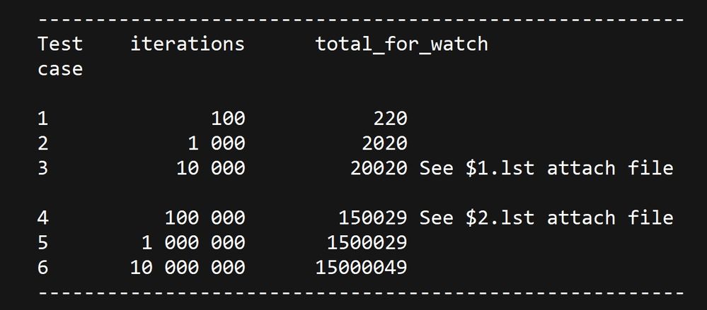

Very simple case for analysis
Hi
To simplify the analysis, I have now concentrated on a single anomaly that is highlighted by simply using the exact same source code except for the iterations parameter which assumes different values (100, ... 10 000 000).
Here I have collected the different suggestions given to me by @Community member​, @TDK​ and @KiptonM​.
  • Interrupt are disabled (__disable_irq(); in line 13).
  • DWT->CYCCNT was used instead of the oscilloscope.
  • All tests now use a single function
  • Disassembly is now available (ATTACH_FILE_#2 list files $1.lst about test case 3 and $2.lst about test case 4)
Follow the code for test case 3 (iterations = 10000).

A summary of the results follows
0693W00000KZvpBQAT.jpgThe anomaly is that in test case 3 to 4 iterations go from 10 000 to 100 000 (x 10) and  total_for_watch go from 20020 cycles to 150029 cycles (x 7.5) !
All tests are with Compiler ARM V5 (in Keil uVision 5.36) without optimizations in C99 mode.
Note. In other tests not documented here I have seen that the total_for_watch  values are consistent with time measurements obtained using digital output
toggles and oscilloscope. I therefore believe the total_for_watch values to be reliable.

TDK
Super User
You're still not calling the function multiple times within the same program. Create a program with all of them within the same program. Otherwise, you still have a compilation step which is changing the code.
uint32_t start = DWT->CYCCNT;
test_function(100);
uint32_t end1 = DWT->CYCCNT - start;
test_function(1000);
uint32_t end2 = DWT->CYCCNT - end1;
test_function(10000);
uint32_t end3 = DWT->CYCCNT - end2;
test_function(100000);
uint32_t end4 = DWT->CYCCNT - end3;
test_function(1000000);
uint32_t end5 = DWT->CYCCNT - end4;
In your disassembly, you can see the compiler is doing different things based on the value you're using. It does seem like an alignment thing.

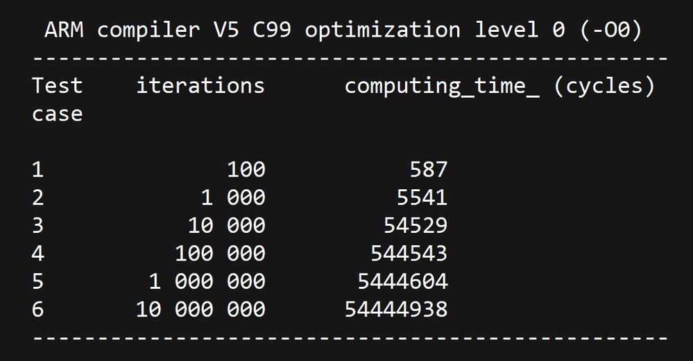

Silvano
Associate II
Hi @Community member​, @KiptonM​, @TDK​  and @Community member​
TDK is right. Test results follow
0693W00000Ka3fnQAB.jpgThe code used follows.

But my original problem was that it seemed strange to me (and therefore I thought I had made some mistakes) that very small changes in the code could result in very large changes in the runtime. For example, consider the following code, which I call %2.
