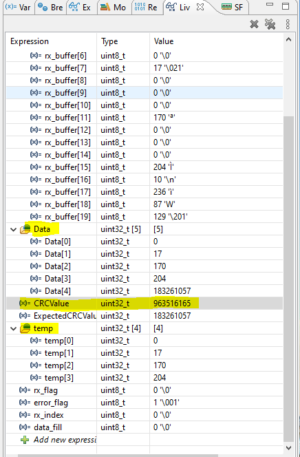

The CRC_Accumulate() function has been called in while loop and the rx_data received as uint8_t and converted into uint32_t and then passed to CRC_accumulate() function in order to calculate the CRC value, but unfortunately the CRC value changes every cycle, what should I do to correct this behaviour?

Alternative while loop: (where the crc calculation is stable but wrong)
Moreover, I tried using flow control flag (i.e. rx_flag=0), but still no sucess, the CRC calculation result is wrong, probably the temp[4] variable was not filled or floating/instable!

The uint32_t CRCValue changes every cycle, although the same rx_data is sent or Data[0-3] and temp[0-3] are same!
PFA Screenshot
What is wrong here? Please help!

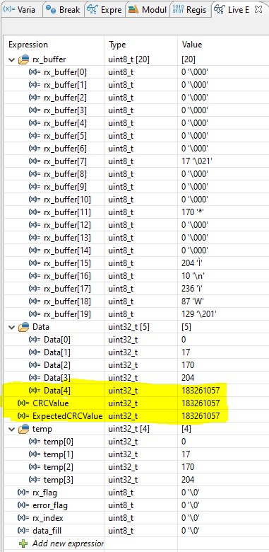

2021-12-16 8:46 AM
I fixed the mistake in the code and now it works perfect!

}The mistake was:
CRCValue = HAL_CRC_Accumulate(&hcrc, (uint32_t *)&temp, sizeof(temp));This was the reason, the calculated CRC value was incorrect before!
Now, I modified as:
CRCValue = HAL_CRC_Calculate(&hcrc, (uint32_t *)&temp, sizeof(&temp));Now, I got the expected CRC value (see the screenshot)!
