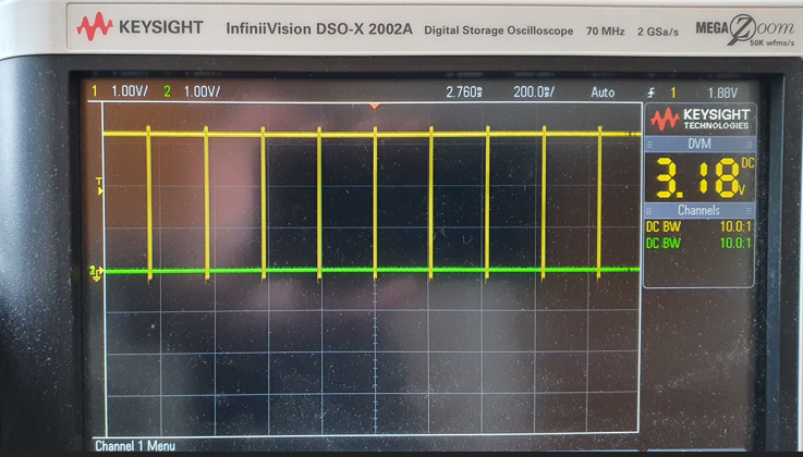

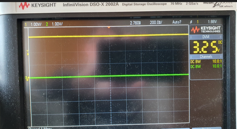

This is measured on the i2c line after a power cycle and stays this way permanently:
And here is after a reset, you can see that the master is attempting to communicate with the slave every 200ms (it is unsuccessful but that's for another question):

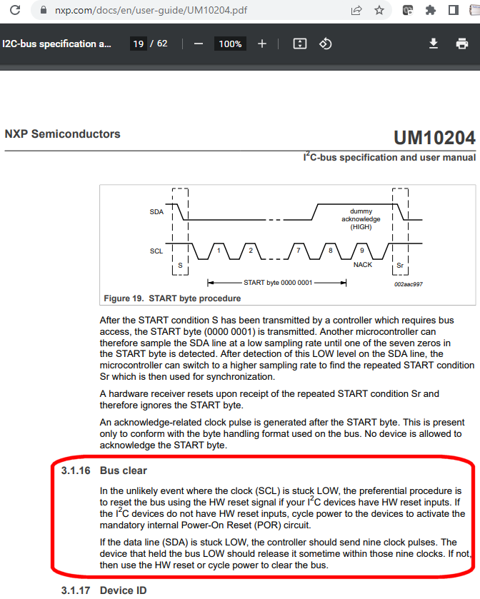

Maybe you I2C peripheral(s) is/are not powering-up cleanly?
It is in the nature of I2C that there's potential for lock-up.
The I2C specification gives a process for clearing the bus:
"I've found the i2c to be by far the most diffcult peripheral to work with on the stm32f4 so far!"
