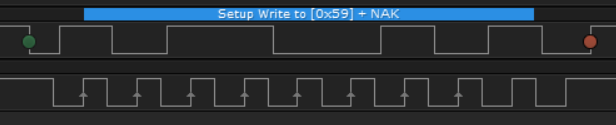

When i choose the slave address 0x59, for example, i do get the correct output (pic), but when i leave it 0x50, nothing comes out from either line.

2019-04-26 11:06 AM
S-10110010-N-P
NACK = 1 = slave not present. Write command failed.
2019-04-26 11:10 AM
Yes i know a NAK is present as the correct device address is 0x50. When i transmit 0x59 i expect to get a NAK as it's the wrong address. What i am having an issue with is that when i try to send 0x50, the SCK and SDA lines don't show anything (they stay high always).
thanks
2019-04-27 4:36 AM
Ok, the test that i was trying to do was flawed. I changed the NBYTES to 0 and it now shows in the scope.
