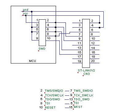

I used this connection scheme:
I went to have a look and most don't seem to have SWO nor TDI connected. Will this make a difference?
The next is to see if I stepped on any DIO pins.

I'm fine now. Lovely to see it working properly!! Serial com interface debugging is very tedious!!
I removed TDI and SWO, oh and uh, SWCLK was actually connected to GND. Ooops. fortunately ST designs for 'anything can happen' environments.
