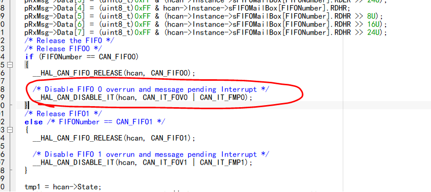

i want to know why the CAN_IT_FMP0 and CAN_IT_FMP1 interrupts are DISBALED in the CAN_Receive_IT () function of the HAL library?

They aren't disabled in the code I'm looking at. Perhaps post the chip you're using and code you're talking about so we don't have to guess.

the function is as follows:
static HAL_StatusTypeDef CAN_Receive_IT(CAN_HandleTypeDef* hcan, uint8_t FIFONumber)
uint32_t tmp1 = 0U;
CanRxMsgTypeDef* pRxMsg = NULL;
/* Set RxMsg pointer */
if(FIFONumber == CAN_FIFO0)
pRxMsg = hcan->pRxMsg;
else /* FIFONumber == CAN_FIFO1 */
pRxMsg = hcan->pRx1Msg;
/* Get the Id */
pRxMsg->IDE = (uint8_t)0x04 & hcan->Instance->sFIFOMailBox[FIFONumber].RIR;
if (pRxMsg->IDE == CAN_ID_STD)
pRxMsg->StdId = 0x000007FFU & (hcan->Instance->sFIFOMailBox[FIFONumber].RIR >> 21U);
else
pRxMsg->ExtId = 0x1FFFFFFFU & (hcan->Instance->sFIFOMailBox[FIFONumber].RIR >> 3U);
pRxMsg->RTR = (uint8_t)0x02 & hcan->Instance->sFIFOMailBox[FIFONumber].RIR;
/* Get the DLC */
pRxMsg->DLC = (uint8_t)0x0F & hcan->Instance->sFIFOMailBox[FIFONumber].RDTR;
/* Get the FIFONumber */
pRxMsg->FIFONumber = FIFONumber;
/* Get the FMI */
pRxMsg->FMI = (uint8_t)0xFF & (hcan->Instance->sFIFOMailBox[FIFONumber].RDTR >> 8U);
/* Get the data field */
pRxMsg->Data[0] = (uint8_t)0xFF & hcan->Instance->sFIFOMailBox[FIFONumber].RDLR;
pRxMsg->Data[1] = (uint8_t)0xFF & (hcan->Instance->sFIFOMailBox[FIFONumber].RDLR >> 8U);
pRxMsg->Data[2] = (uint8_t)0xFF & (hcan->Instance->sFIFOMailBox[FIFONumber].RDLR >> 16U);
pRxMsg->Data[3] = (uint8_t)0xFF & (hcan->Instance->sFIFOMailBox[FIFONumber].RDLR >> 24U);
pRxMsg->Data[4] = (uint8_t)0xFF & hcan->Instance->sFIFOMailBox[FIFONumber].RDHR;
pRxMsg->Data[5] = (uint8_t)0xFF & (hcan->Instance->sFIFOMailBox[FIFONumber].RDHR >> 8U);
pRxMsg->Data[6] = (uint8_t)0xFF & (hcan->Instance->sFIFOMailBox[FIFONumber].RDHR >> 16U);
pRxMsg->Data[7] = (uint8_t)0xFF & (hcan->Instance->sFIFOMailBox[FIFONumber].RDHR >> 24U);
/* Release the FIFO */
/* Release FIFO0 */
if (FIFONumber == CAN_FIFO0)
__HAL_CAN_FIFO_RELEASE(hcan, CAN_FIFO0);
/* Disable FIFO 0 overrun and message pending Interrupt */
__HAL_CAN_DISABLE_IT(hcan, CAN_IT_FOV0 | CAN_IT_FMP0);
/* Release FIFO1 */
__HAL_CAN_FIFO_RELEASE(hcan, CAN_FIFO1);
/* Disable FIFO 1 overrun and message pending Interrupt */
__HAL_CAN_DISABLE_IT(hcan, CAN_IT_FOV1 | CAN_IT_FMP1);
tmp1 = hcan->State;
if((tmp1 == HAL_CAN_STATE_BUSY_RX0) || (tmp1 == HAL_CAN_STATE_BUSY_RX1))
/* Disable Error warning, Error passive, Bus-off, Last error code
and Error Interrupts */
__HAL_CAN_DISABLE_IT(hcan, CAN_IT_EWG |
CAN_IT_EPV |
CAN_IT_BOF |
CAN_IT_LEC |
CAN_IT_ERR);
/* Change CAN state */
switch(hcan->State)
case(HAL_CAN_STATE_BUSY_TX_RX0):
hcan->State = HAL_CAN_STATE_BUSY_TX;
break;
case(HAL_CAN_STATE_BUSY_RX0_RX1):
hcan->State = HAL_CAN_STATE_BUSY_RX1;
break;
case(HAL_CAN_STATE_BUSY_TX_RX0_RX1):
hcan->State = HAL_CAN_STATE_BUSY_TX_RX1;
break;
default: /* HAL_CAN_STATE_BUSY_RX0 */
hcan->State = HAL_CAN_STATE_READY;
break;
switch(hcan->State)
case(HAL_CAN_STATE_BUSY_TX_RX1):
break;
hcan->State = HAL_CAN_STATE_BUSY_RX0;
break;
hcan->State = HAL_CAN_STATE_BUSY_TX_RX0;
break;
default: /* HAL_CAN_STATE_BUSY_RX1 */
break;
/* Receive complete callback */
HAL_CAN_RxCpltCallback(hcan);
/* Return function status */
return HAL_OK;

They appear to be disabled after the end of reception occurs.
/* Check End of reception flag for FIFO0 */
if((tmp1 != 0U) && tmp2)
/* Call receive function */
CAN_Receive_IT(hcan, CAN_FIFO0);
