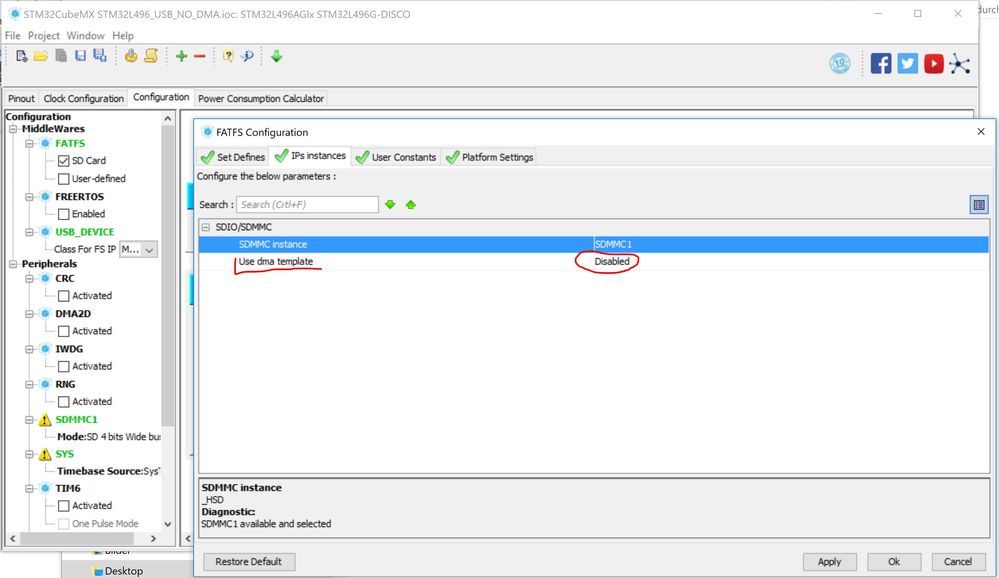

I think your problem is DMA related. CubeMx generates wrong SDIO - DMA Code . There are plenty of discussions here.
https://community.st.com/0D50X00009XkXgUSAV
Just read throug the Forum.
In order to use Sd Card without DMA you have to config Cube Mx properly. I found that it integrates DMA even if you did not choose it, thats why your programm fails.
Here I postet the solution
https://community.st.com/0D70X000006Ss9JSAS

2018-03-05 11:39 PM
The CubeMX project has always had Use DMA Template Enabled.
DMA is not being used.
