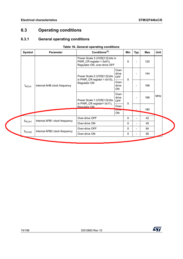

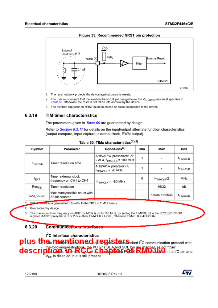

I'm using timers with DMA and I was asking myself of the use of having different clocks for timer clock and timer bus. For example timer 2 has a 90 MHz clock and a 45 Mhz bus. What would be the limitations of the bus?
