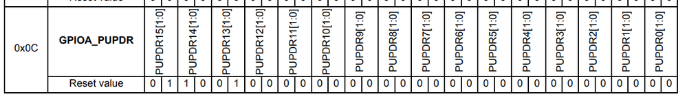

Due to stm32f303rct6 refrence manual (RM0316) p. 243, the reset value of GPIOA_PUPDR register for PA8 and PA11 are equal to 00. This means that the output of them are not pull-up or pull-down under reset state,
