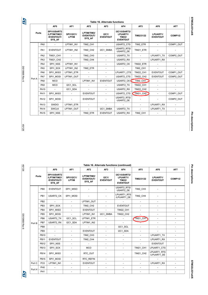

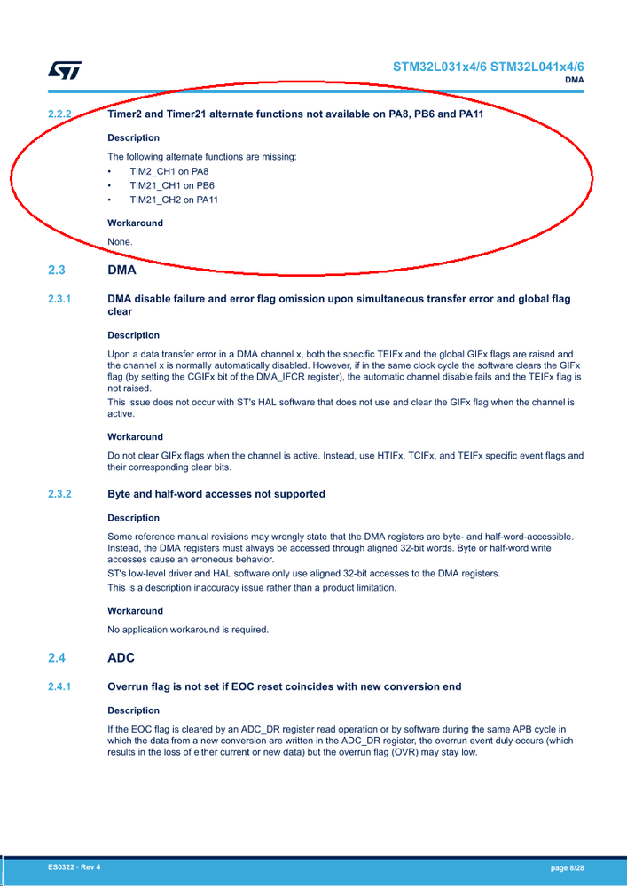

yet
and of course also in the pins table.
Why??
OK I take it back - this is pertinent only to rev.A of the chip; there are newer revisions where this (and other rather disturbing errata) is already fixed.
