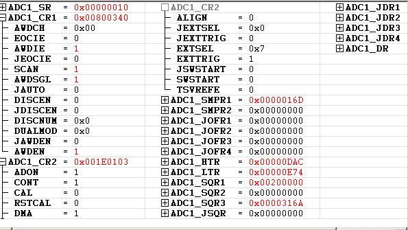

The registers seem to be set correctly....
The analog voltage read in is 3794. Since the high threshold is 3700 shouldn't the analog watchdog have been triggered?
2018-10-24 7:07 AM
Correction...
uint16_t lowThreshold = 3300;
uint16_t highThreshold = 3500;
Actual still 3794.
I was changing thresholds to and the previous was incorrect. No matter what the threshold I don't get the interrupt.
