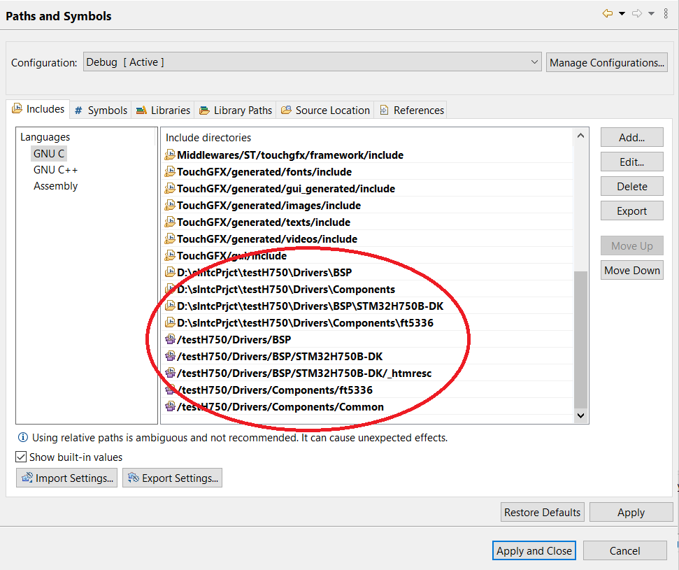

Hello @ksale.1 ,
The issue it can be in the include paths.
Check the project properties/options -> Include paths tab, then add new paths to your include directories.
Hope my answer helped you!

Hello @Imen DAHMEN
The directories are already in the paths as you mentioned,. The problem is the config files do not exist in the H7 MCU Package v1.10.0. I'm currently deleting/re-installing the package.

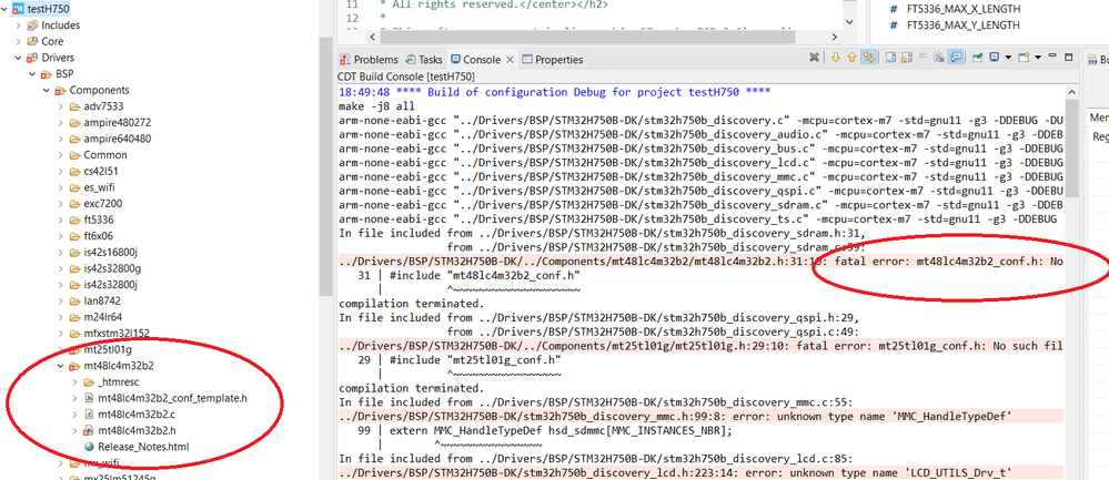

The file names are templated as in the below screen shot, while the compiler is complaining about ...config.h not found! You help is greatly appreciated
