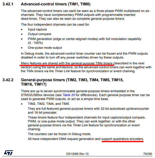

I am trying to use the quadrature encoder mode of the TIM in the STM32U585VITx, for positioning purposes of a stepper motor movement.
According to DS13086, page 79, the general purpose timers (TIM2, TIM3, TIM4, TIM5, TIM15, TIM16, TIM17) support quadrature encoders.
However, according to RM0456 Rev 5, page 2083, TIM 1.8 has support for quadrature encoders.
Could you please clarify which TIMs support this encoder?

2024-10-21 1:58 AM
@Elham wrote:According to DS13086, page 79, the general purpose timers (TIM2, TIM3, TIM4, TIM5, TIM15, TIM16, TIM17) support quadrature encoders.
It also says that TIM1 & TIM8 share many features with the GP Timers - so that could include encoder support
The datasheet is really just giving a quick overview - the Reference Manual gives the complete description

Thanks for your quick reply Andrew,
But just saying "Many features are shared with the general purpose TIMx timers" is not enough for me.
Also, on the 2nd page of the DS13086 it says that only two of the timers support this feature:
Up to 17 timers and 2 watchdogs:
- 2 16-bit advanced motor control
Which I think is inconsistent with the explanations in 3.42.2.
Thank you

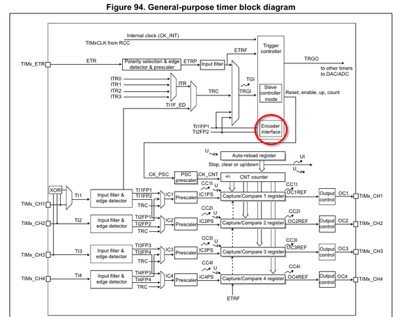

2024-10-21 8:25 PM
You can also look at the Timer diagram.

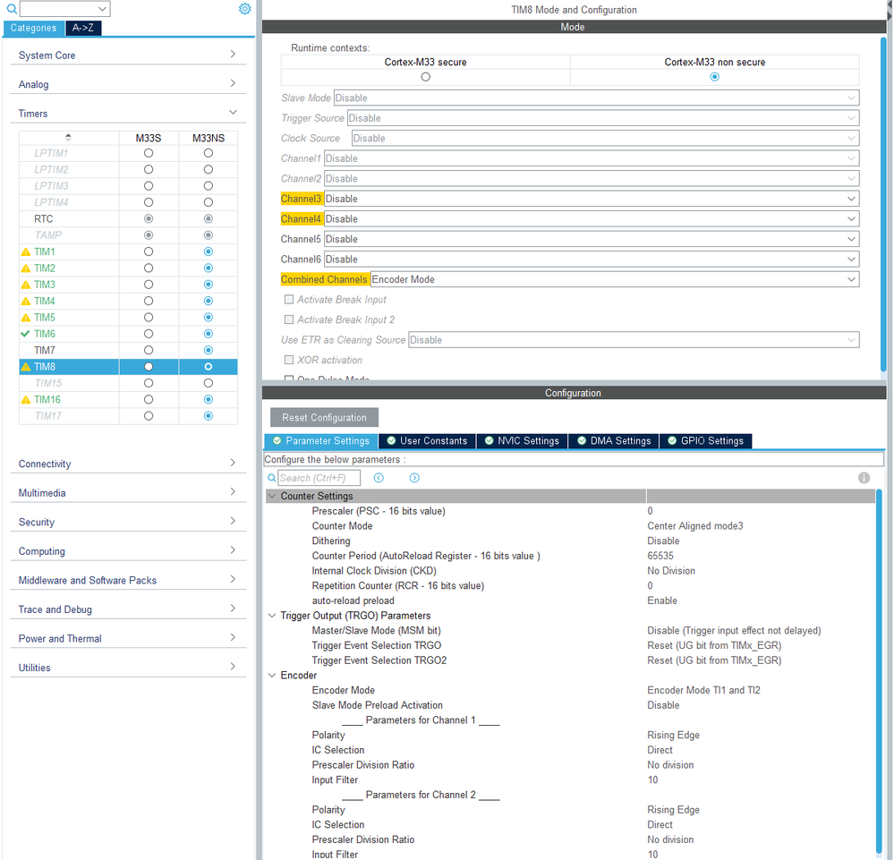

2024-10-22 1:19 AM
Thanks all for your hints and help :)
I am using STM32CubeIDE to configure TIM. I have posted my settings here. I have also included the auto generated tim.c. I have also tried to add some user code to this file, but no difference and I still get a bunch of zeros when I read the encoder like this:
uint32_t motor_ctl_get_encoder_value()
return (uint32_t)htim8.Instance->CNT;
void MX_TIM8_Init(void)
/* USER CODE BEGIN TIM8_Init 0 */
/* USER CODE END TIM8_Init 0 */
TIM_Encoder_InitTypeDef sConfig = {0};
TIM_MasterConfigTypeDef sMasterConfig = {0};
/* USER CODE BEGIN TIM8_Init 1 */
/* USER CODE END TIM8_Init 1 */
htim8.Instance = TIM8;
htim8.Init.Prescaler = 0;
htim8.Init.CounterMode = TIM_COUNTERMODE_CENTERALIGNED3;
htim8.Init.Period = 65535;
htim8.Init.ClockDivision = TIM_CLOCKDIVISION_DIV1;
htim8.Init.RepetitionCounter = 0;
htim8.Init.AutoReloadPreload = TIM_AUTORELOAD_PRELOAD_ENABLE;
sConfig.EncoderMode = TIM_ENCODERMODE_TI12;
sConfig.IC1Polarity = TIM_ICPOLARITY_RISING;
sConfig.IC1Selection = TIM_ICSELECTION_DIRECTTI;
sConfig.IC1Prescaler = TIM_ICPSC_DIV1;
sConfig.IC1Filter = 10;
sConfig.IC2Polarity = TIM_ICPOLARITY_RISING;
sConfig.IC2Selection = TIM_ICSELECTION_DIRECTTI;
sConfig.IC2Prescaler = TIM_ICPSC_DIV1;
sConfig.IC2Filter = 10;
if (HAL_TIM_Encoder_Init(&htim8, &sConfig) != HAL_OK)
Error_Handler();
sMasterConfig.MasterOutputTrigger = TIM_TRGO_RESET;
sMasterConfig.MasterOutputTrigger2 = TIM_TRGO2_RESET;
if (HAL_TIMEx_MasterConfigSynchronization(&htim8, &sMasterConfig) != HAL_OK)
Error_Handler();
/* USER CODE BEGIN TIM8_Init 2 */
uint32_t tmp = TIM8->CR1;
tmp = tmp | 0x00000001;
TIM8->CR1 = tmp;
sConfig.IC2Selection = TIM_CCMR1_CC2S_0;
/* USER CODE END TIM8_Init 2 */

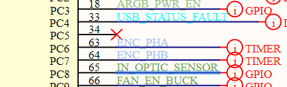

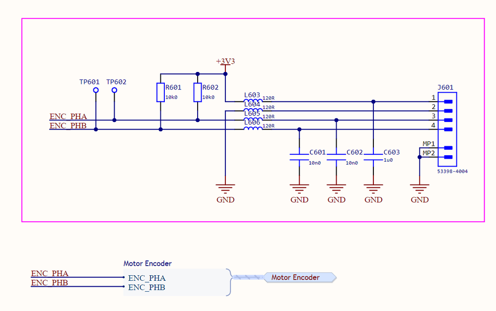

2024-10-22 1:27 AM
Please also show a schematic of how you are connecting the encoder, etc
2024-10-22 1:44 AM
Thank you Andrew,
I attached that part of schematic. Pins numbers 63, 64 of the MCU are used for this.
