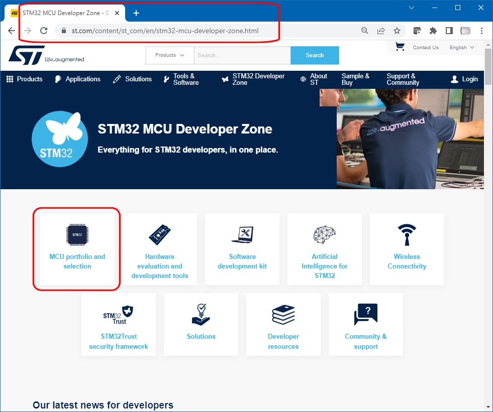

STM32CubeMX MCU selector is your friend.

Have you tried the "STM32 Finder new mobile app" ?
Or the Product Selector?
