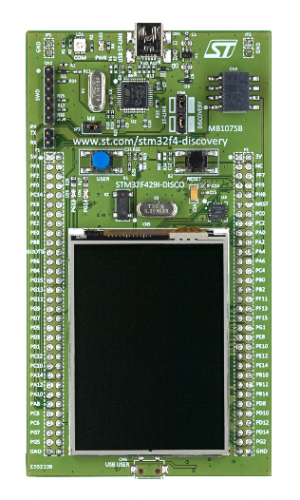

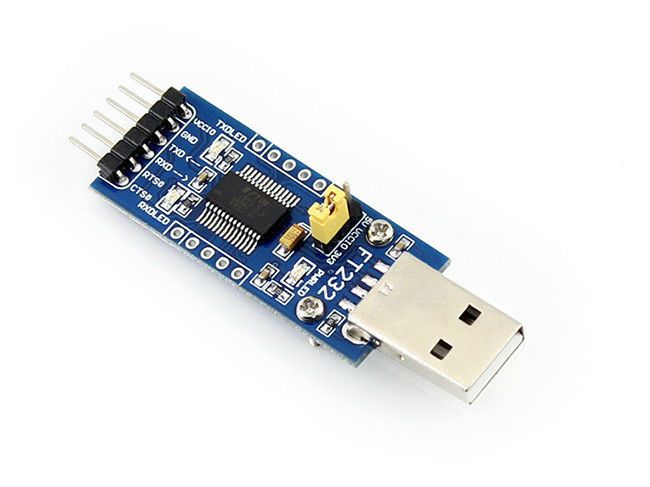

I'd like to test UART in STM32F429-DISCO kit, and I buy UART to USB board
But I don't know what pins are using in UART test with .STM32F4xx_DSP_StdPeriph_Lib_V1.8.0
Could you please let me know which pins should I have to connect between
STM32F429-DISCO kit and UART
to
USB
board ?

There is a pin list on page 20 of the User Manual

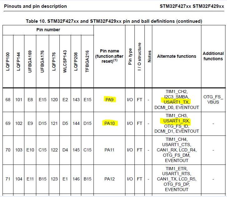

Isn't USART1 connected to the VCP on the DISC1 board? via PA9 and PA10
SB11 and SB15 control connectivity there. These could be removed and signals would be available at the headers.
USART1_TX going to the RX pin of an adapter.
Some free pins seems to be PD5 USART2_TX, PC11 USART3_RX, PC12 UART5_TX, PF6 UART7_RX
Chip pin lists can be found in the Data Sheet

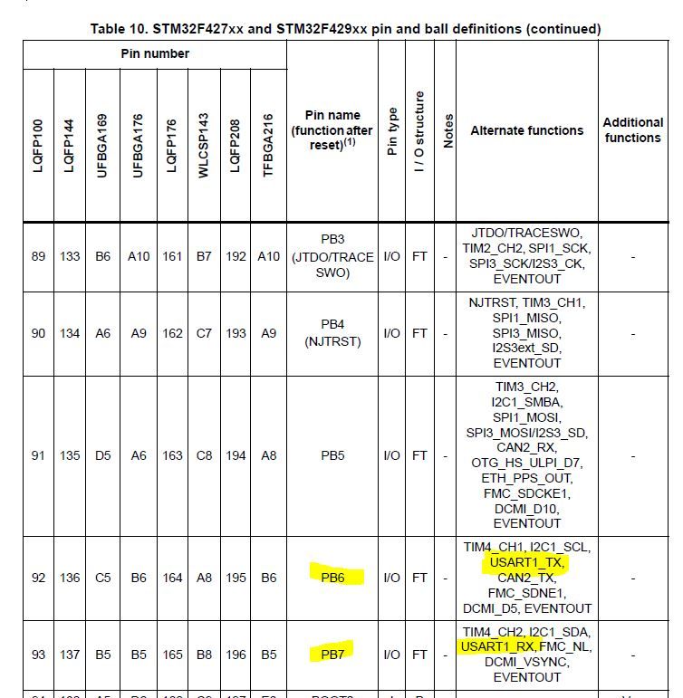

I'm actually confused that manual saying USART1_TX : PA9, PB6 , and USART1_RX: PA10, PB7.
How am I supposed to know which pin is used for USART1 TX,RX.
Even the example code does not use alternate mode. how do we know which function does it use after reset.
What I mean is for example PB6's function is defined as TIM4_CH1, I2C1_SCL, USART1_TX,CAN2_TX...
Here 's example code of USART, I can't see the any information of alternate mode.

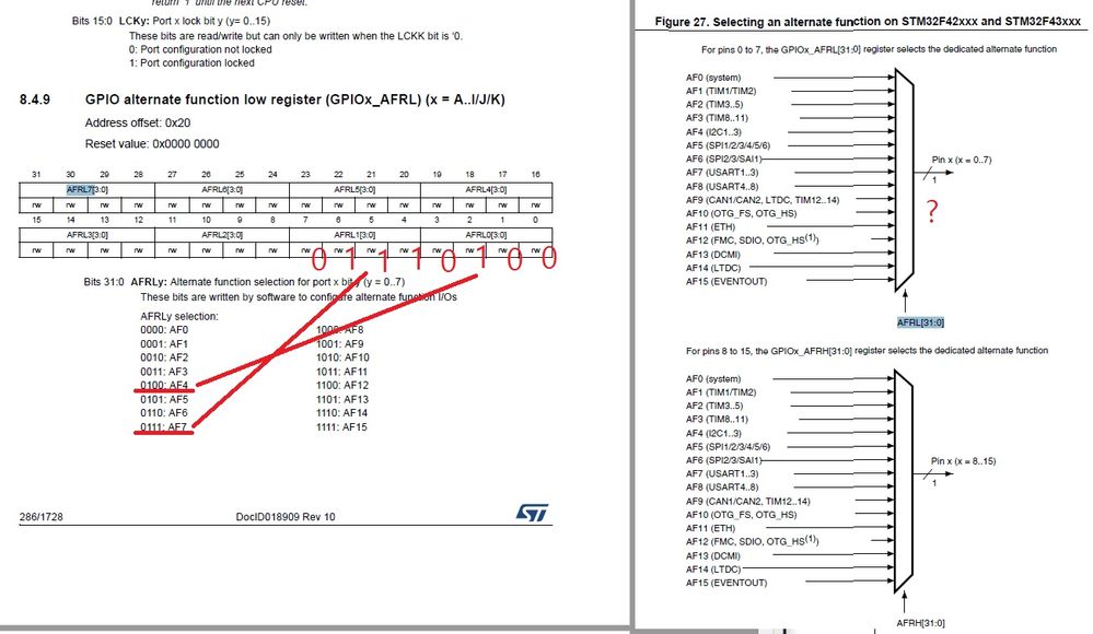

The function can be multiplexed to multiple pins. The pin basically contains a sixteen way switch which controls which peripheral uses the pin. The secondary table in the Data Sheet describes these with AF0..15 settings.
The code to configure the pins would be under STM_EVAL_COMInit()
The pin via GPIO_Init(), the function via GPIO_AFConfig()

I'm confused that how does GPIO_AFRL[31:0] register exactly do as AFRLx and trying to understand alternate function as AFRL as the image below.
for example If I set GPIOA_AFRL = 0x
0000_
0000_
0000_
0000_
0000_0000_0111_0100,Then what happens?
I can't understand the relationship between left and right image at the below.
I can't see the Information of ''
The pin via GPIO_Init(), the function via GPIO_AFConfig()'',
Especially,
