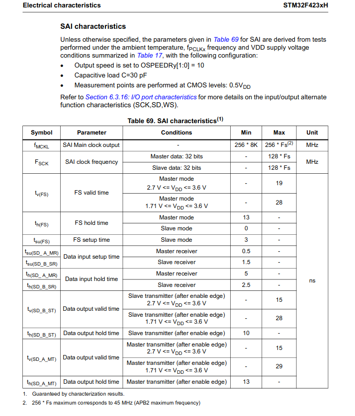

Looking at the data sheet of the F423, I'm not sure I understand it completely:
Is "Fs" supposed to be the incoming sampling frequency? So 256ksps * 128 = 32.768MHz in slave mode? And is this PER 32-bit slot? So only 64ksps per channel? Very confused.
TIA.

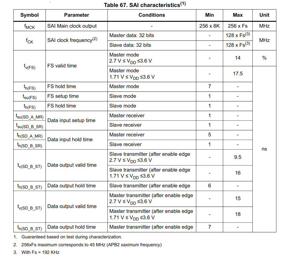

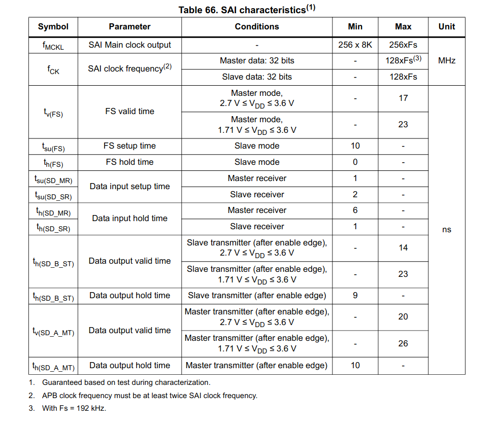

Here is the relevant page for the F446: And the F469:
If the intent behind the SAI interface was to limit it to 192ksps, they should simply state that in the description. It would save a lot of people a lot of grief.

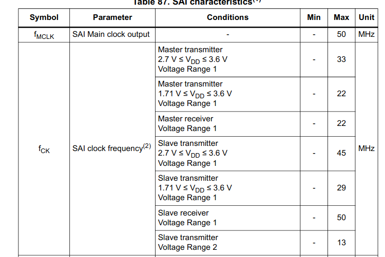

Finally, here is the G431:
Here, it *clearly* states that the maximum slave clock speed is 50MHz. Is this because the max APB1 clock frequency is 170MHz vs 50 and 45MHz in the F4?
