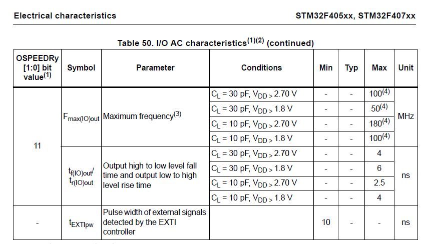

Hi
This is STM32F405 Datasheet.

2019-04-26 2:42 AM
Hi.
It was not my intention to show switch speed but max freq. (i miss to highlight the Max freq)
100 MHZ has 10ns toggling time. STR instruction executes in one cycle so it is possible to produce the 100 MHZ/2 freq by write to ODR directly.
2019-04-26 3:01 AM

Vangelis: 100 MHZ has 10ns toggling time - that would be more than enough!
2019-04-26 4:15 AM
"that would be more than enough!"
But not by software. . By software you can produce maximum 168/2 = 84MHZ (12ns) for a limited number of cycles by continuously writing STR instructions (assembly). And no Wait States, Interrupts, Power optimizations, etc
