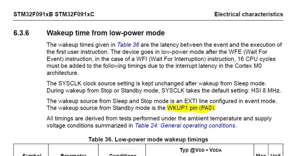

Hi
Code seems ok.
I found an interesting point in Datasheet. Shouldn't be written.
Try to Wake Up the MCU with PA0 pin, if works need further investigation..
