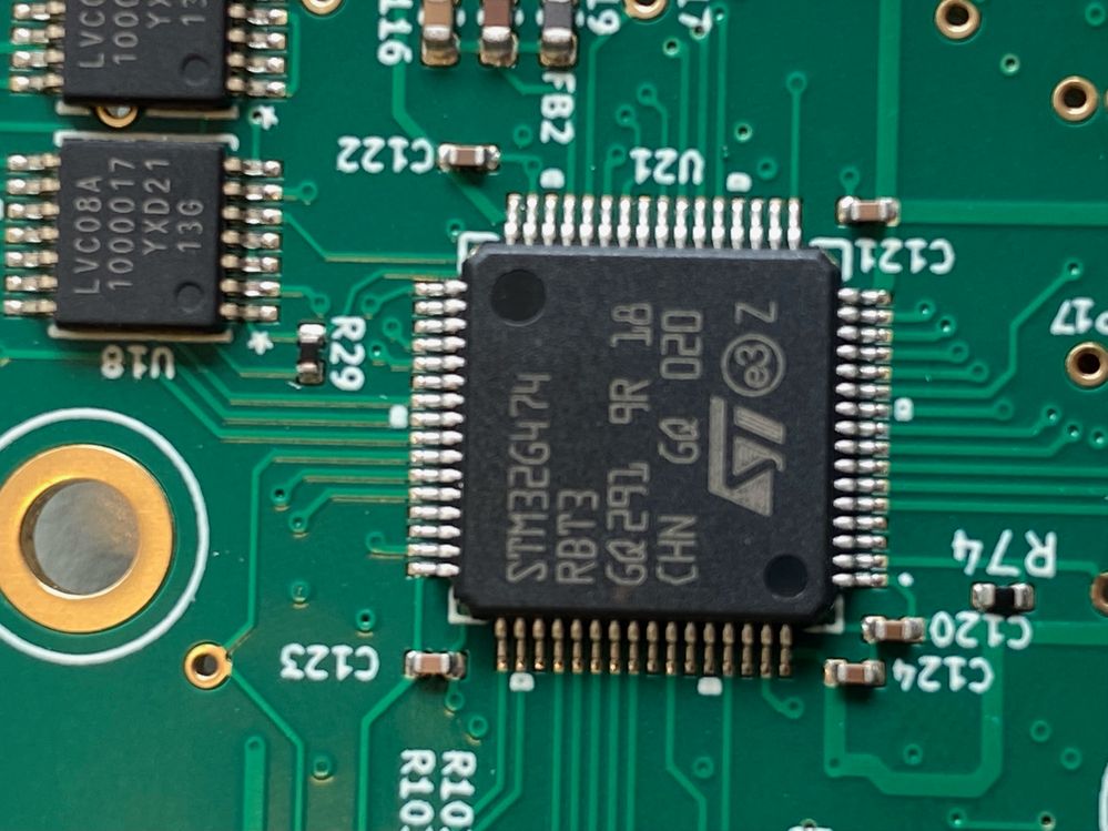

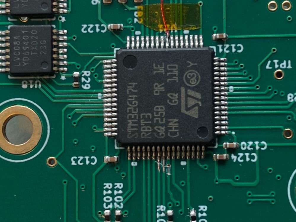

They look the same but I one of them is running the firmware right after plugging the power source, and the other is not. The revision letter is different on both (Y and Z). Is there a way of comparing the changes between both revisions? Thanks in advance.

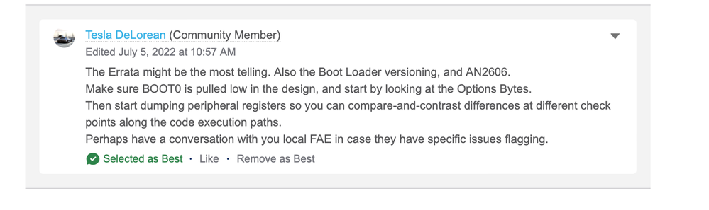

The Errata might be the most telling. Also the Boot Loader versioning, and AN2606.
Make sure BOOT0 is pulled low in the design, and start by looking at the Options Bytes.
Then start dumping peripheral registers so you can compare-and-contrast differences at different check points along the code execution paths.
Perhaps have a conversation with you local FAE in case they have specific issues flagging.

"They look the same"
But the boards aren't the same.
