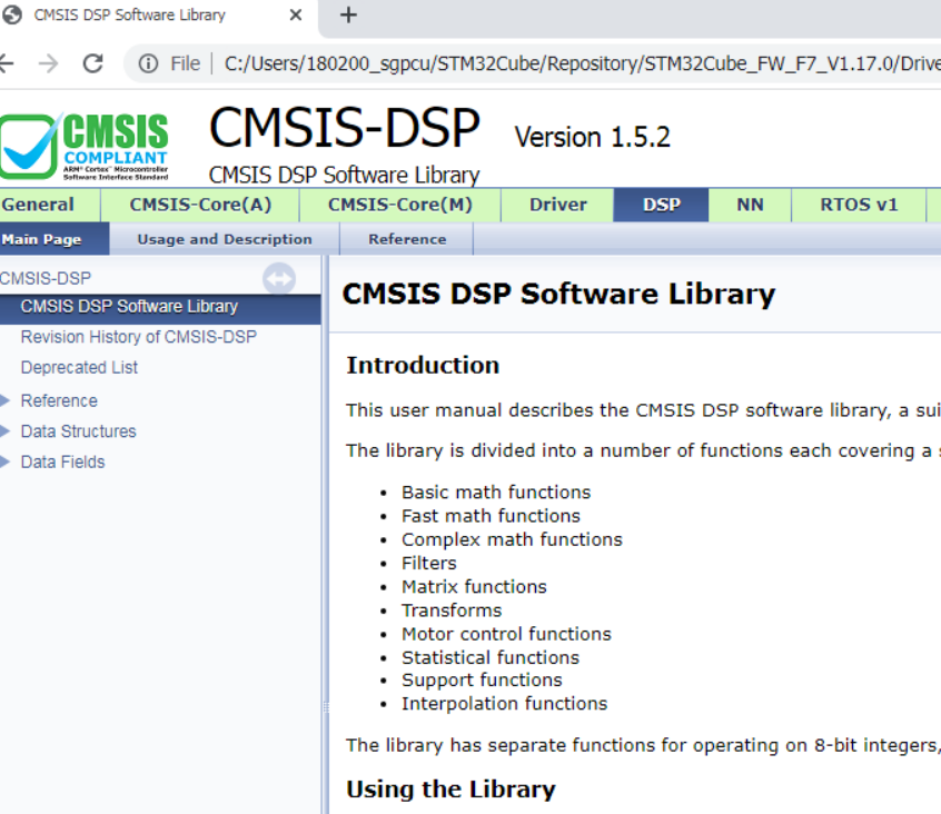

2022-11-29 7:40 AM
Did you able to figure out how to use quaternion math functions from DSP library. I downloaded latest CubeMx and the version of the DSP is 1.5.2 as shown below
It misses lot of functionalities like matrix vector operations.
Thanks in advance.
