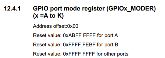

Hi @TAcha.1 ,
Look to the reset values of GPIO registers in the reference manual (RM0399) to get the exact answer. Here an example:

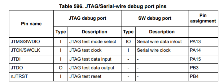

Pins used for debug purpose are the ones where there is an exception:
