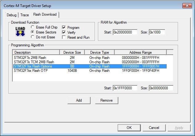

2018-04-07 1:10 PM
The method in Keil is to direct content to a specific section/load-region, and then select a flash algorithm that manages the option bytes. Figure structure, attribute, scatter file/linker script, and programmer that deals with the .HEX

2018-04-07 3:04 PM
Your picture of the Keil options is what I would expect from a professional level IDE. With options for full/partial erase, and settings for the sections of memory to program. Though I would also expect a settings page somewhere with the specific options for the specific processor.

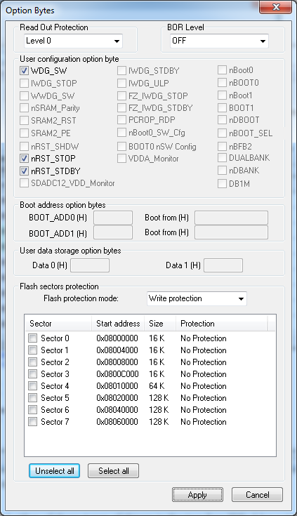

2018-04-07 4:48 PM
I set mine through the free ST-LINK Utility which I also use to download the code...
2018-04-08 4:54 PM
That makes sense to have that in the ST-Link utility. To me though it seems like you should also be able to define those within CubeMX and within the project settings of the IDE. After all, the 'I' in IDE is for 'Integrated'. All the same functions that the ST-Link utility has should also be available within every IDE. I can see using the ST-Link utility as a production programming environment, instead of the IDE. But you shouldn't have to run an external utility to set those things during development. You should be able to do everything from within the IDE.
