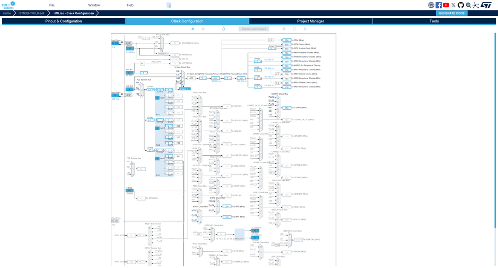

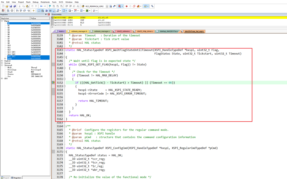

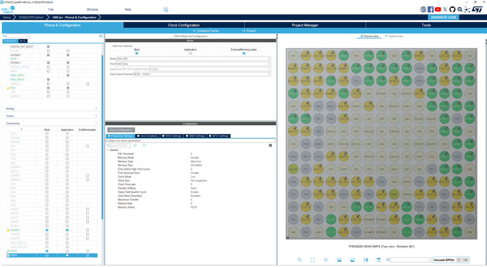

STM32H7R7L8H6H XSPI2 is mounted with MX25UM25645GXDI00, and the frequency setting exceeds 133Mhz. The Boot program fails to run and gets stuck in the "XSPI_WaitFlagStateUntilTimeout" function.
Please help me!XSPI2 Configuration
Clock Tree Configuration

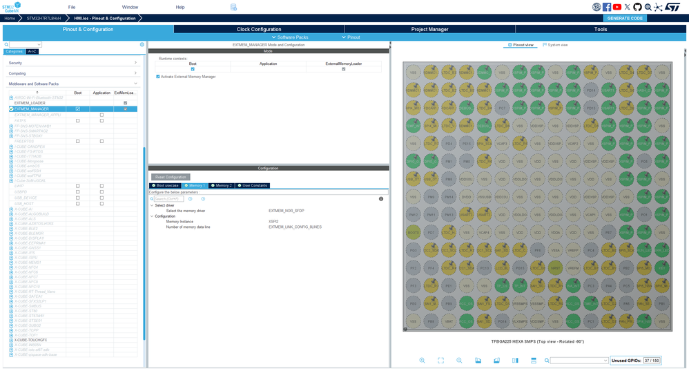

EXTMEM_MANAGER Config 1
EXTMEM_MANAGER Config 2
Stuck here

The issue has been resolved. Simply open HSLV in STM32CubeProgrammer and enable the high-speed mode
