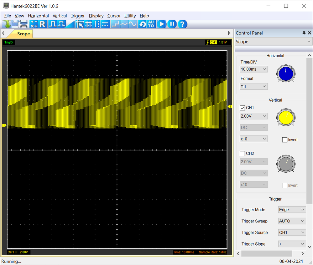

I run and investigate the code in step, and the code jumps to "Reset_Handler:" at the line "__HAL_TIM_ENABLE(htim);" in the API "HAL_TIM_PWM_Start".

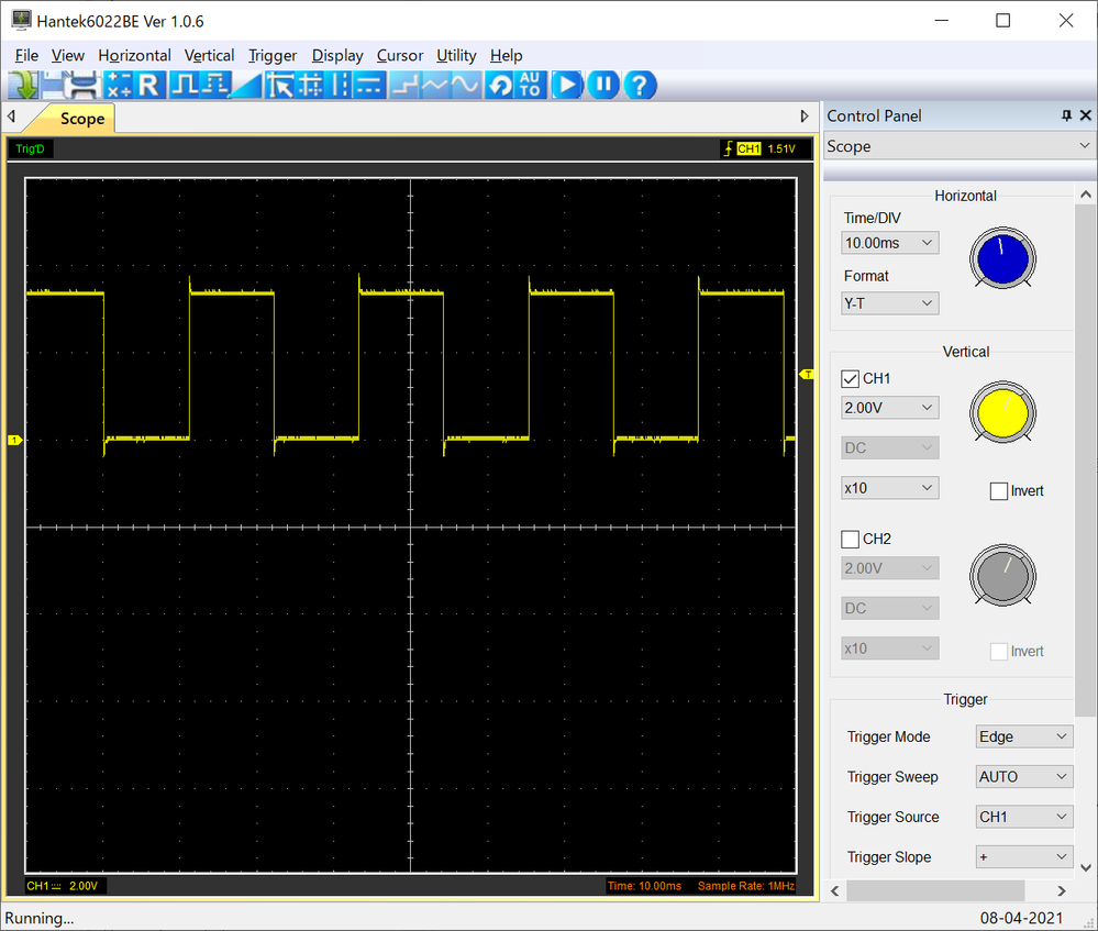

The code repeats execution and reset. The GPIO pin is as above.
If I comment out "HAL_TIM_PWM_Start(&htim2, TIM_CHANNEL_1);" in the above code, it reach "while" successfully. The GPIO pin is as follows.
I set my project as default except for each PIN and TIM2. I set TIM2 Channel1 to "PWM Generation CH1".
